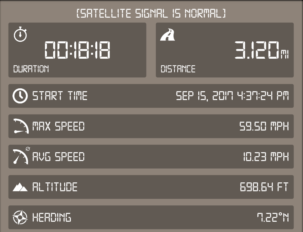

I installed the 160mm setup today. I talked to Glen at Skat-Trak and he recommended a Big Hub Long Blade impeller in a 13/18 pitch. He sent a 13/16, and I'm so tired of sending parts back and forth I pitched it myself to around 18.
There must be something wrong, because cavitation is much worse than stock, and there's a vibration from 2000 to 6000 rpms. Hole shot is still much better than stock. Top speed was 59.5mph, on the rev limiter at 8550 rpms. I added all 3 rings to the Lucky 13, and it ran 1mph slower but didn't drop rpms.
Still some fine tuning, but if I can get the rpms down and find the source of cavatation this will be a winner.

I put the 155mm setup back in today. Before installing, I pitched it down about 1mm. Last time out with this impeller it went 59.17 @ 8350 rpms. I'm hoping for 60+ mph @ 8450 tomorrow.
The 155mm setup ran smooth, but no faster than before. 58.5 mph @ 8250 rpm. It was hot and we had a lot of extra weight in the boat. I ran up the lake while the water was smooth with the wife and kids with me. Ran 57 mph at 8200 rpm for 5 miles with no heat fade. AFR was 11.8. Total weight of people and gear was around 700lbs + full tank of fuel.
