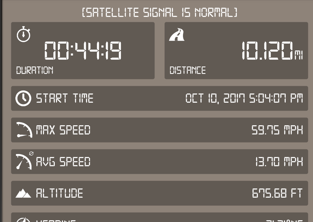

Tested tonight. Still has the same cavitation/vibration. Acceleration is not as good as the repitched stock 155mm impeller. The top speed is surprising. It ran 59.75 mph @ 8150 rpm with 3/4 fuel, myself and 2 kids.
There are some sharp edges at the transition from 155mm to 160mm. Once the vibration is figured out, I'm sure there will be some gains in filling/polishing those transitions smooth.
I like where it is pitched for now. I'm going to send it to Impros for their opinion on the vibration.
