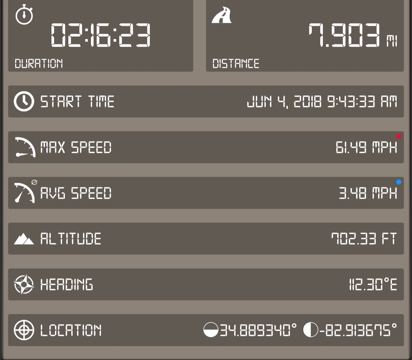

New top speed today. Ran 60.14 with 2 adults, 3 kids, 2 coolers and full fuel. Unloaded the coolers and family and ran 61.5 mph with just myself in the boat. The impeller just got back from Dean getting a repitch, so its running 8500 rpm now.
That's all I'm going to do as far as performance goes. Just going to enjoy it and get the surf setup dialed in.
