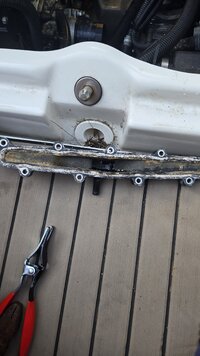

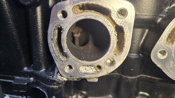

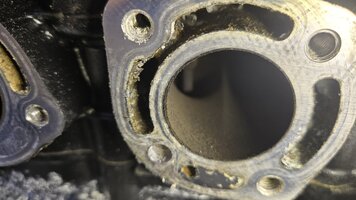

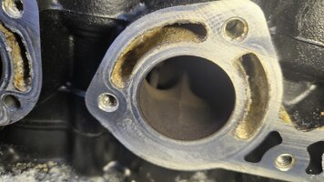

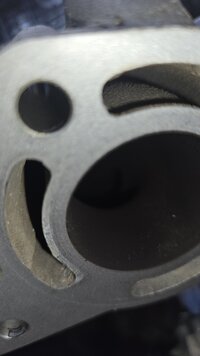

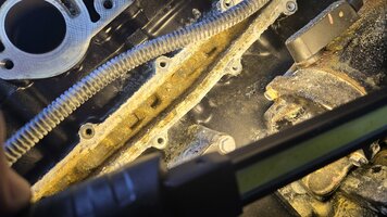

Finally got around to taking the exhaust manifold off the side of the boat, life and being terrified. I think things look pretty good for a 12 year old boat, see attached. Do you think I might of missed something on the way thats stopping water? first four pictures are each exhaust hole from the front back, last picture is the exhaust side, they all look new.
Looks very clean and unrestricted

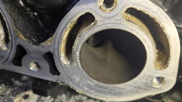

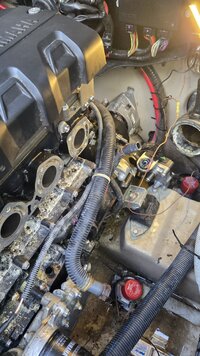

Ok getting sadder, haven't found anything that looks blocked yet, going to try and blow air through I guess, I have most of the hoses off and everything I can see in the waters path
See attached

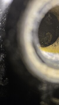

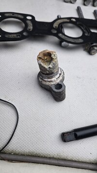

Anode and best I could get of the anode hole, both look good for being 5 years old, stumped here
