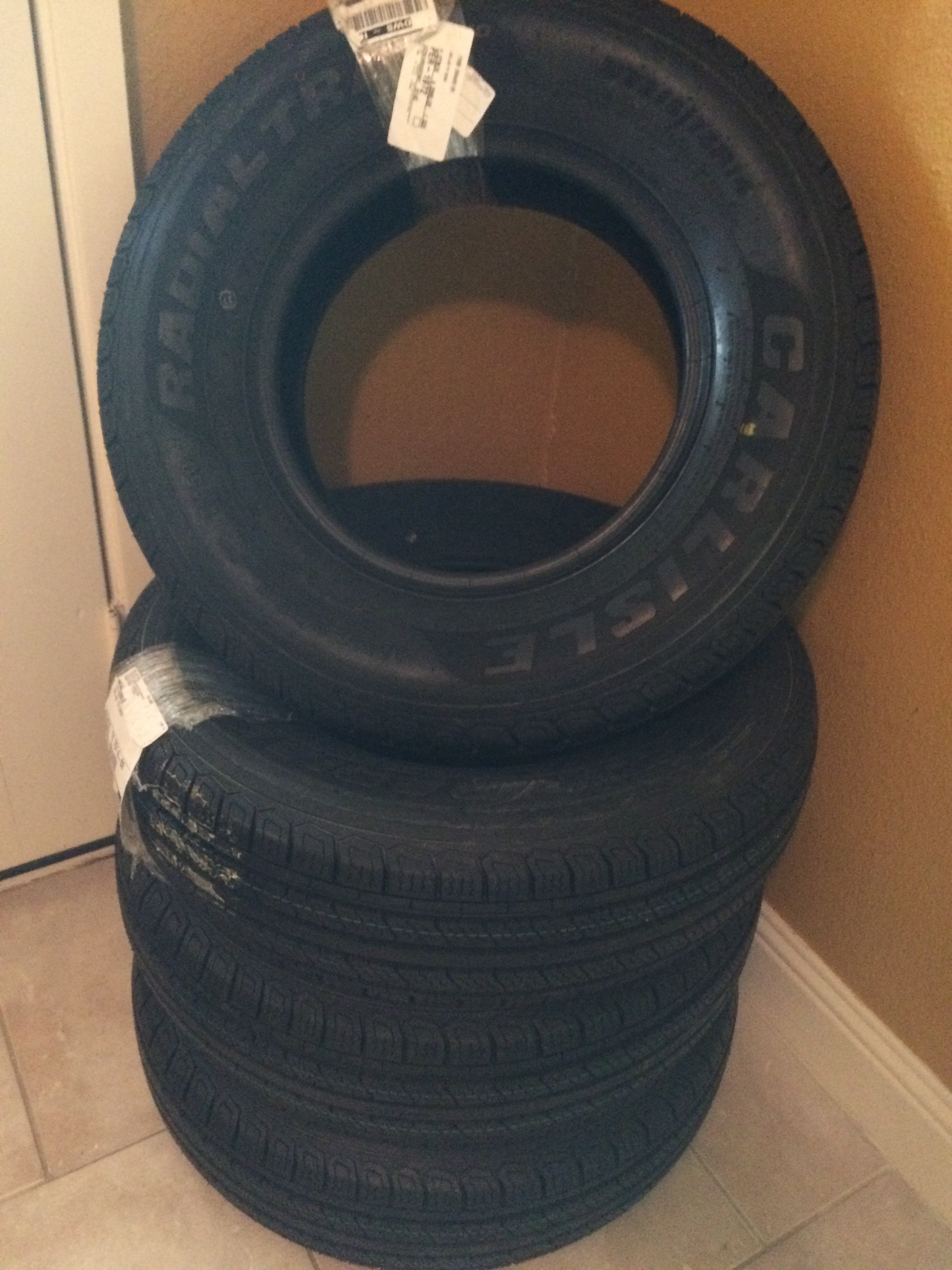

Got my tires today. Tires only. Once I get the trailer back will be heading straight to discount tire to get them switched out and
