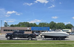

I want to go and look at this boat. Im seriously considering buying it. Never owned a boat. Been around bass boats and whatnot growing up. Out the door 43k. Seems a little high... what are some things I should check? Its at a dealer. No maintenance records. Said it came from Chicago. Seems to be in great condition.
Looks pretty clean. I have the same model and year and have been very pleased with it. Paid $45,000 in August of last year.
