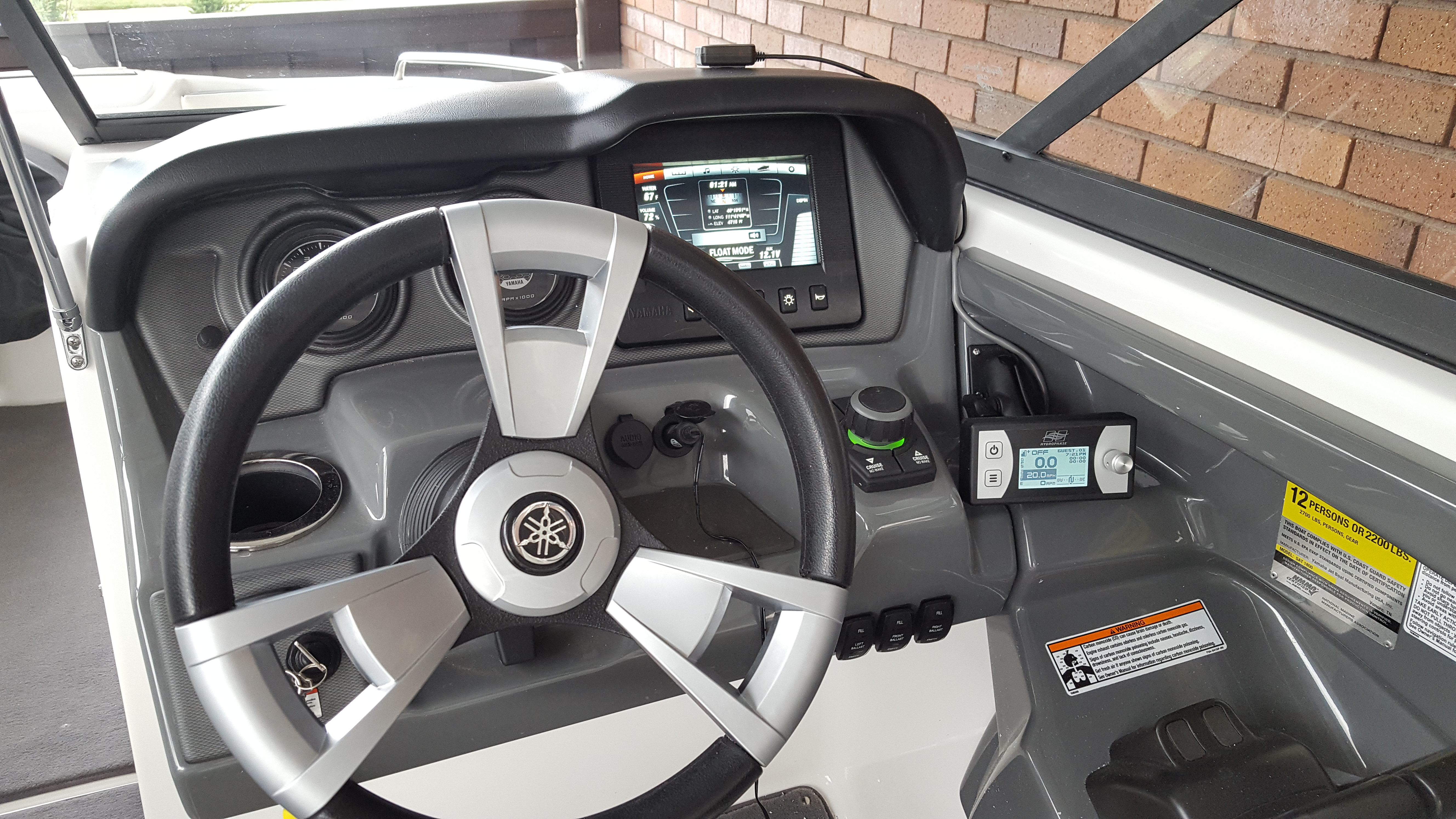

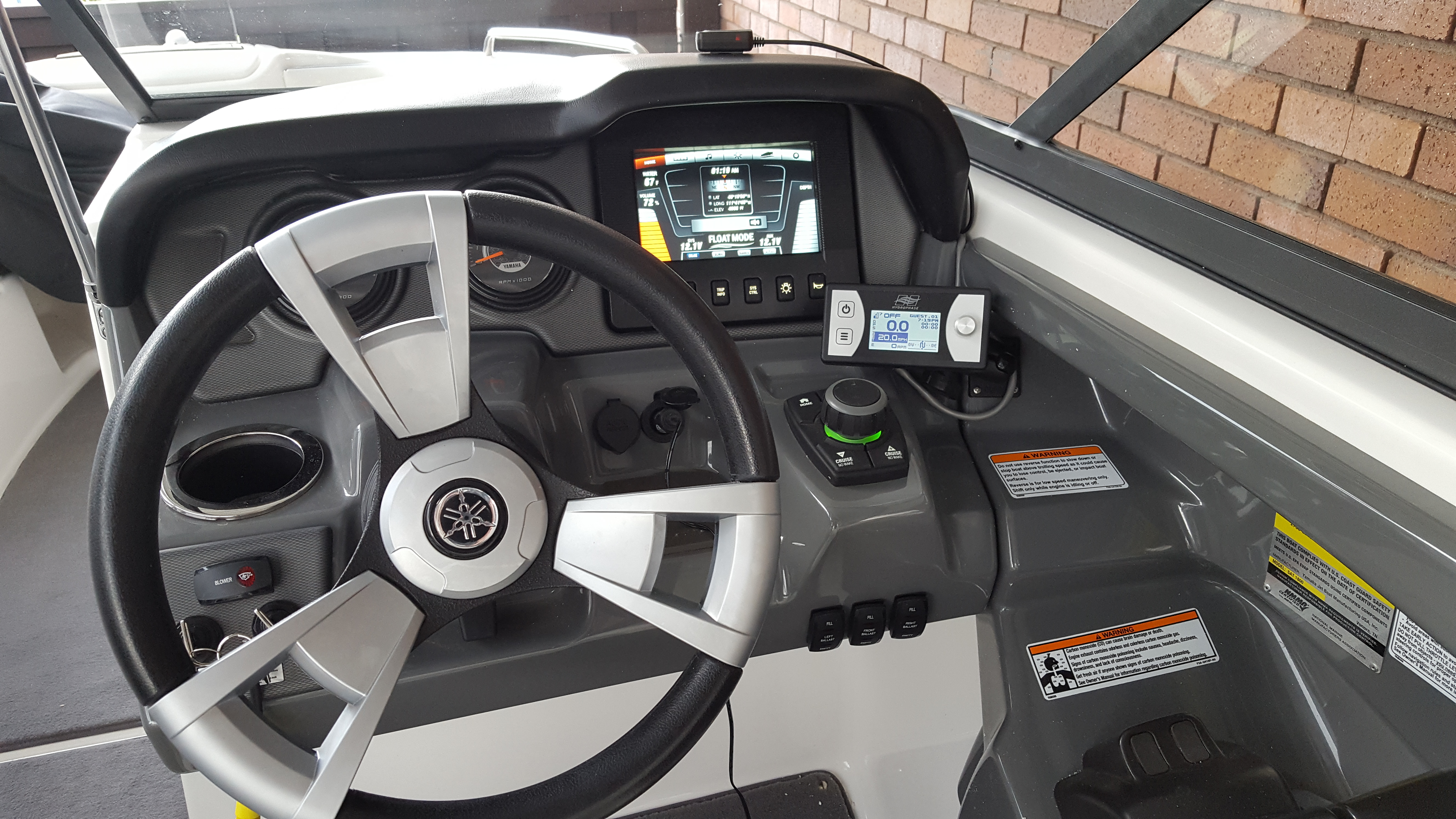

It's alive!! Planing to hit the water for a test run on Sunday. It was a fun install... I'm really pleased with where I decided to mount the unit in the space to the right of the CoNext controller. It allows me to position it up near the screen or down near the throttle levers.
