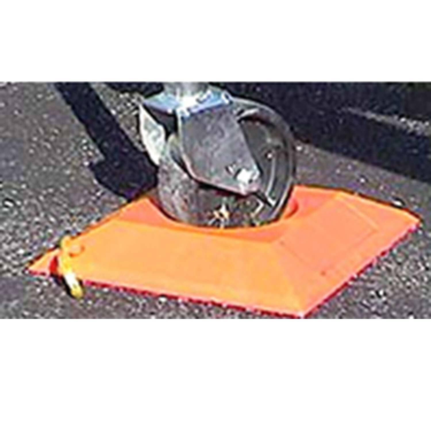

Is there any dis-advantage to going with a flat bottom instead of wheels? I have yet to have an instance where I needed the front wheel. The wheel scares me since it can move the front of the trailer.
The wheels don't actually have a brake, but you can position the wheels and lock them in what ever position you choose. Also, it's recommended to place the jack closest to the coupler as possible. The black model is not currently available, so I have the galvanized one.

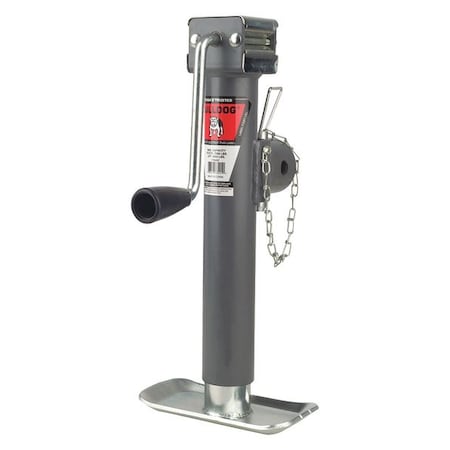

You could get something like this
I've been thinking of something like this, if I do replace it, though I do need something with an extended lift.
If it were me, I would put one of these on each side as supplements. No way I'm trusting that 5000 lb. rating.
What makes you distrust it?
It doesn't look any more robust that the 1000 lb Dutton-Lainson I'm replacing. I'm sure it may be sturdy, but what about when it's extended? I have no first hand knowledge other than looking at the picture.
