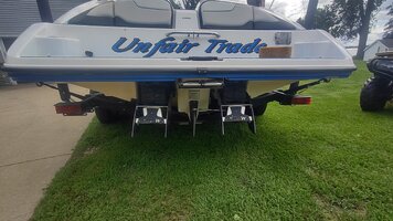

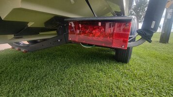

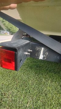

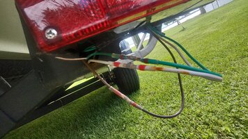

Didn't do this today, posting up a past project for @AZMark. Swapped the Shorelander OEM incandescent trailer lights for replacement LED versions from Amazon.
I would recommend LOW for your heat gun, or get a smaller wand-type of heat gun. I didn't have the wand type, and this was the first time I used these solder connectors. Pics show too much heat on the white wire. I added a half-round attachment to the heat gun, and turned it to low, and this project is what prodded me to get a wand-style heat gun for future electrical projects on the boat and for tight spaces.
I had thought that I added heat shrink over the connection as well, but pics show that I didn't. I did cut the wires of the old light to leave myself as much wire as possible for future repairs or replacement. Everything just shoves back into the trailer frame. Bolts match up with the OEM lights, so no drilling was required
