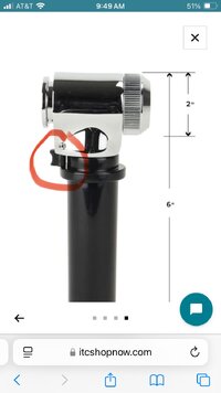

Another long shot, but could the lock on your sprayer be engaged? One time I locked mine to let the water drain and forgot that it was locked and the pump just kept running.
I have a different hose than you. However, my hose is not stuck on. I can turn the hose off at the sprayer while it is plugged into the raw water and it works as it should. Then I swap it and plug it into the fresh water, the sprayer will spray (although not full pressure) and the pump will continuously cycle on and off.
