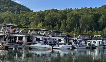

This is the last row. We wouldn't block anyone. Everyone else ties their boat up on the stern of their boat, but they tie up port/starboard to stern of houseboat.
Maybe this is a bad idea...I'll add that some of the neighboring boats are 30' longer than the one we would be in....

I think tying up like those boat pictured, is a much better idea…
With a stern to stern tie up there is a lot of leverage port / starboard and you’d have very oblique, almost straight back dock line angles.

I agree with you completely, however, with two longer houseboats on each side of us, I'm not sure we can tie up like that. We will be there for the first time in a few weeks. I might have to wait it out and see in person. I just figured that someone had done this.

Right on…. Usually the beam on those houseboats is 14’ or greater… what’s the story on the grey Yamaha in the picture? Size?
I think it was an AR230. It's sharp. I thought it was teal at first...then pulled up closer.
Okay, so it is 2’ shorter than your boat, and it looks like he is good on tying up that way, based on that, do you think you’ll have room to tie up the same way?
Possibly....just trying to make a plan B so when the neighbors both have their boats tied up too.

So this worked extremely well…and no we could not have tied starboard to stern. Too tight between the other boats. Also, this made the swim deck too easy to step on, and off.
Two mid cleats tied to sides on stern of houseboat, two spring lines, and drop anchor for an overnight.

Glad to see that worked out well!
