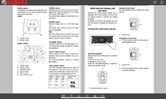

So the anchor light, are you saying that after turning the engines off, but with the keys still and in float mode, the anchor light comes on? Is the anchor light only controlled via the touch screen only or is there a manual switch too that could be on as well and that’s why the light comes on? On some boats, critical functions have manual switches, sometimes in addition to touch screen switches.
From the 2025 255XD Owners manual

Your owners manual is not available online yet so I can’t see it, but I’d be surprised if there isn’t a manual switch down there on that panel. You might want to look for that and see if that solve the issue.
