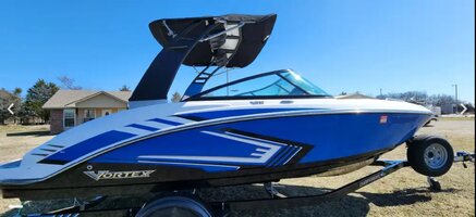

I want to replace my wet batteries to lipo, can I just swap them or would it be an issue with the charging system?
Depends on what type of charging system you have. Lots of threads on here about this process. Check my signature for the link to my journey.
I have a 2019 Chaparral 203 vortex vrx with Rotax 4 tec 1630 ACE engine, I purchased 2 lipo batteries thinking It was as simple as swapping them, but just found out that is not the case and they are not refundable so I own 2 expensive paper weights....what do you recommend me to do?
