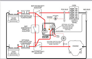

I attached a link of a post that has a step by step and picture. Is this the correct way of wiring?
Okay sound
okay sounds easy enough, and connect the wire ring terminal directly to the battery positive screw?
No, you connect the ring terminal to the switched side of either the start or house battery switch so that when the switch is off there is no power to the dvsr red wire.
Yes as long as the “B” terminal pictured is de energized when the switch is in the off position.
