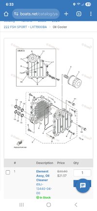

69J-13440-04
5GH-13440-80
These are the P/N's I see in various kits online. Perhaps the middle number is what drives the P/N and the rest are new vs old versions?
This is the correct oil filter for the 1.9l
69j-13440-80
The 5gh is for the tr1 3 cylinder engineScreenshot_20251023_183301_Chrome.jpg
