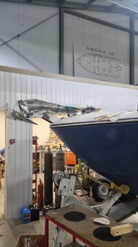

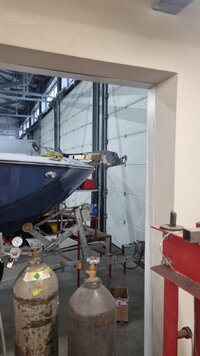

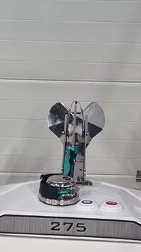

Has anyone installed a windless anchor on their Yamaha 275? I’m thinking about doing it and would like to look at detailed pictures of existing installs and know what equipment you had to buy. I searched all the forums, but couldn’t find any examples.
I plan to cut through the front of the hull since it’s just not possible to put one on top of the bow because the anchor locker wouldn’t close, and I would lose the front bow cleat. TIA.

Here is the thread where cycle springs put one on a 275. It’s through the stem as you thought would be the best way to do it.

Well, a very nicely done job , I’m not crazy about how low the anchor and wonder if it’s possible to do it with the anchor coming straight out and higher. I’ll have to do some measuring, but at least now I know it’s possible. Good idea to put some weight up there and see how the boats attitude is impacted.
