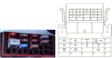

Hi All, I want to add some switched accessories to my 195 open. The switch panel has two "unused" switches Acc1 and Acc2. Seems they are fully wirde into the boats main harness, But I dont see where they get the power from and how much amperage each can "take"? I don't need something crazy, 10A for a freshwater pump on one and some led lights on the other. And, if anybody knows, are these switches fused with blade fuses in either fuse box or the breakers in the boats engine power panel? Thanks!
Picture of my fuse holder (inside center console) and the diagram from the scarab manuel... now I am even more confused... that makes no sense at all!
I don’t know Scarabs… my suggestion would be to get a test light or multimeter and check the switch to confirm there is voltage and start pulling those fuses one by one too see if they’re the source of power. If not you’ll need to dig around and find the source and or run a feed to the switch.
Did some more “diggin”. The switches have power, they even have wired “outlets” (switched side) that seems to go to connectors in the wiring harness. Maybe someone has a wiring diagram?
If I were you, I would tap directly off the battery, fused, and switch it with a relay. This way, you don't have to worry about running too much power. That's what I did.
