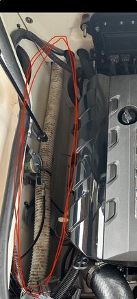

Hi all,
I'm currently shopping for a used 2019 or newer AR195 and I've seen a few boats that have a lot of dirt/discoloration/mildew/carbon buildup(?) on the white tubing along the engine (see pic). But, some boats with more hours the tubing is clean.
If the tubing is dirty is that a red flag for any issue? Does it mean more moisture is getting in the engine compartment or that it has been stored outdoors poorly?

Looks like mold … is it no where else in the engine bay.
Very common for that hose to get mold on it. It condensates so it can be damp. Just needs to be cleaned properly
That makes sense! Thank you
Once cleaned up, spray everything with silicone spray to keep things looking good and shed any moisture.
