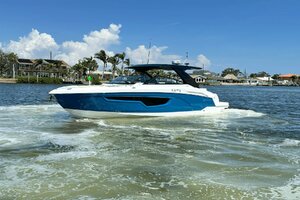

Cruisers Yachts 34gls. We're not much for overnighting on boats, but the theory is that bigger will be better when it comes to venturing farther afield and staying out all day. The boat handles great and is super comfortable. And it's still small enough that we can still get into and out of just about all of the places we go with the 255. The cabin and head are surprisingly large for what amounts to an overgrown bowrider. Amazing what they can stuff into these. I still have the 222XD in Maryland. Ideally, I'd have sorted out the logistics of selling the 222 and transporting the 255 up to Maryland but it would have been a hassle. I like the 222XD nearly as much, and it doesn't suffer from the "dreaded" reverse steering issue, so it has that going for it :)
