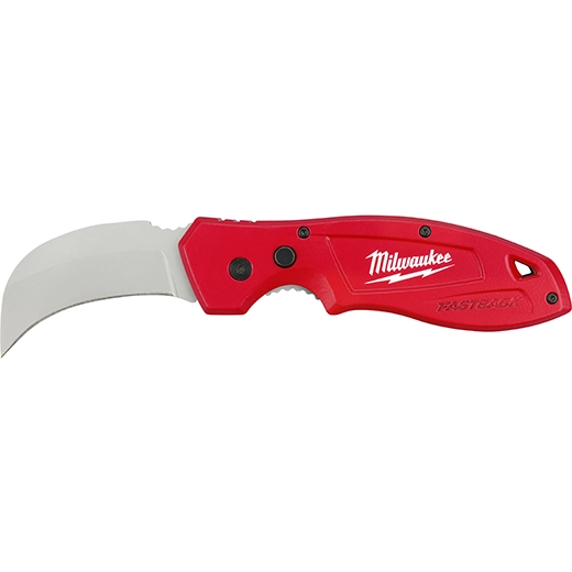

This knife is what I have in addition to my utility knife and pocket knife
I also keep a mask, snorkel, and fins on my boat.

I have the hawksbill Milwaukee knife @FSH 210 Sport showed, and that has saved my bacon for weeds, but no rope so far. Not a great fan of the steak knife, as I have to consider dealing with it when I have the grandkids, but that's definitely a good idea if someone is comfortable with it. On the Milwaukee knife, Throw a lanyard through it for WHEN, not if, you drop it!
