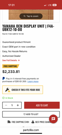

My YES warranty just hit 5 years in May of 25. How much was the connext? dam!

mine was replaced thru warranty...I think the part is between $500 and $1,000 but the hard part is getting one. Many times they are backordered for months/years and some vendors raise the price substantially.. I would check with Dealer, and then find the correct part number and check the online parts stores.
