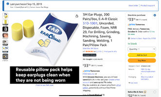

We get more wind noise on our boats than the bow rider boats do. I use these when I’m trolling all day by myself and all the time when I’m cruising any distance, or when using lawn equipment, riding dirt bikes using power tools etc…after six years I’ve still got well over half of these left.

@FSH 210 Sport Love the ear plugs! classic.
