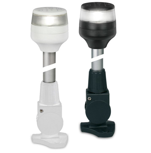

I just noticed my anchor light for my FSH is missing the plastic globe that covers the bulb. Does any one know of a replacement? It looks like Yamaha only sells the full assembly. Amazon has replacements just need to know if its Perko or Attwood I guess.

I just ordered both, it should be delivered tomorrow so I guess we will see.

It's attwood, for future reference for those that run into that problem. Would imagine they use the same light that they do on other yamaha boats.

What did you find out?
So neither of the 2 repalcements I ordered from Amazon worked. The Attwood one was too small. Did some more research this morning and it looks like this is the replacement light assembly Amazon.com : Attwood 5358-P12-7 Folding All-Round Incandescent Pole Light 12” : Sports & Outdoors Much cheaper then getting from Yamaha. From whatI can tell this is the correct replacement globe for it Amazon.com : Attwood 912852-7 Replacement Anti-Glare Globe All-Round Navigation Light - White : Boating Navigation Lights : Sports & Outdoors. West Marine has them for half the price as Amazon but they are our of stock around me so Im ordering today.

I put a led bulb in mine to cut down the current draw… but will be installing a led anchor light on the hard top.
What about of of these?
Page 62 in the Atwood catalogue

I did a LED replacement bulb too. Much brighter and less draw as you said.

Yeah, I screwed the pooch a bit when I installed it..folded the tabs down and had to use a seal pick to straighten them out. Will be camping out on the boat this summer several times so need to have that working properly… I’m going to run a on land test one night here at the house to see how much the battery gets drawn down.
