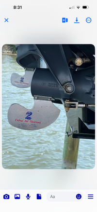

This video was made by a customer trying out his cobra super ultimate ak-19 deluxe steering for the first time, he made this video on his own watch him make waves behind the trailer and then drive up to the trailer and park the boat on it..
Also my steering is adjustable and spring loaded so if you want the fins to rise up out of the water at speed you certainly can do that, I tell people whre to set the fins and they usually use that setting remember my tempered aluminum fins are super fins with a special design to automatically change the steering influence they provide based on the position of the hull in the water so when you need more influence you automatically get it

2024 FSH Sport H Cobra Jet Steering.
I installed the Cobra Jet steering fins and tested on the lake yesterday. One word….Amazing!!
The install is simple but I did spend time ensuring the fin was aligned (clocked) perfectly with the nozzle.
I noticed the difference the moment I backed off the trailer. Low speed control was much better. Obviously the helm control is the way to go around a dock, but the Cobra fins provide more control in the absence of the articulating keel.
My complaints with this boat from the first day on the water were …constant drifting at trolling speed (3-5mph)…left turn every time you cut the throttle and come off plane…drifting when on plane at speed.
Tested yesterday with 10-15 mph winds with moderate rollers from wake boats and bass tournament. Trolling speed required very little to no input to maintain course! As a fisherman this was my primary concern. Problem eliminated!! The left turn dive also eliminated. Drifting at speed reduced significantly.
Is it worth it?? Absolutely!!
I hope this helps the others that have been asking about this system.
