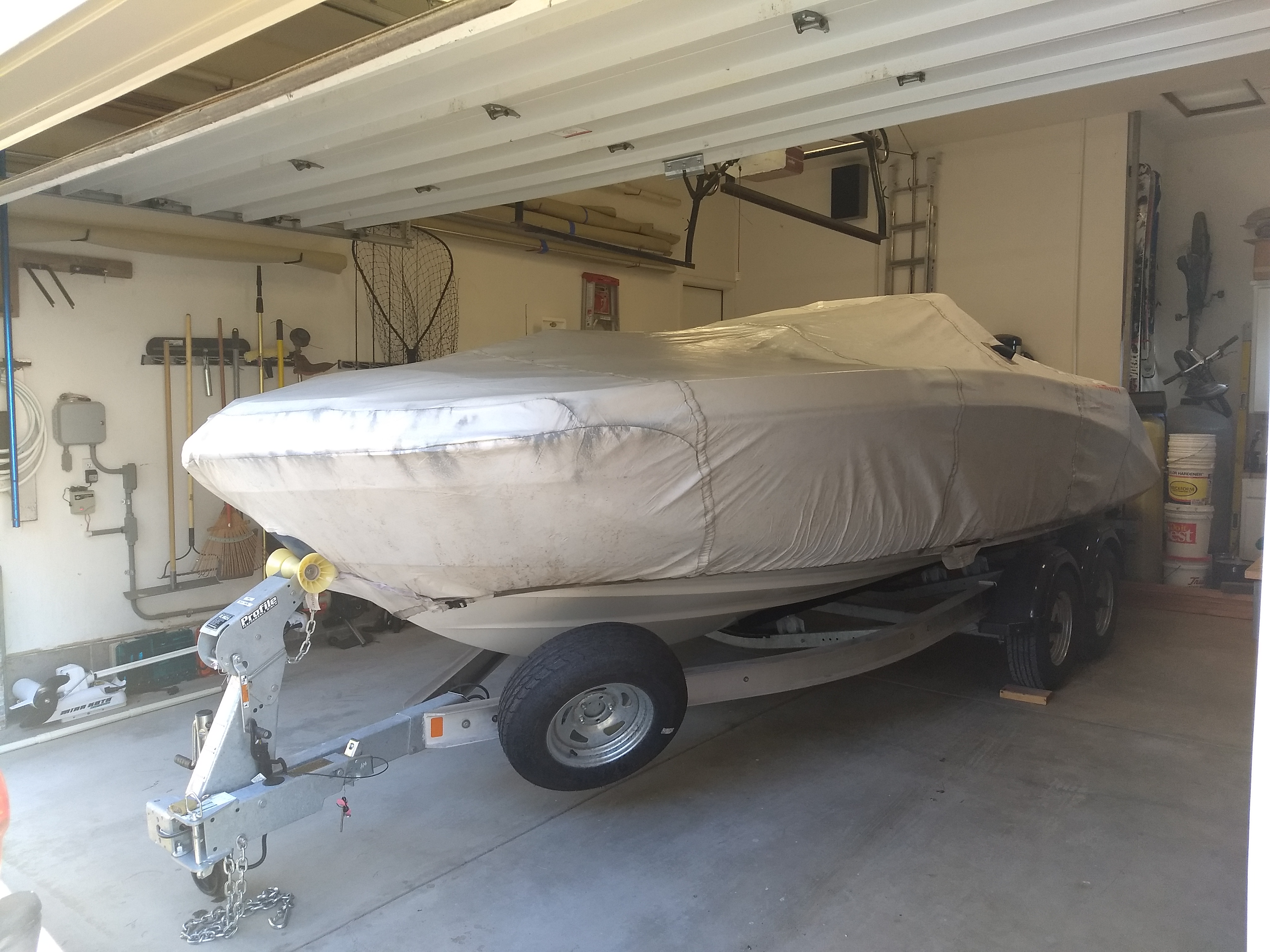

I was able to get it into my garage (7'-4"), but I had to increase the garage door rise to accommodate the seat cushion. There's a 3" gap at the base of the door when it's closed.
It does go straight in @ 22'. Not any room for cars though.
