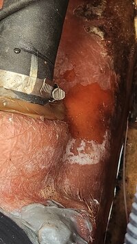

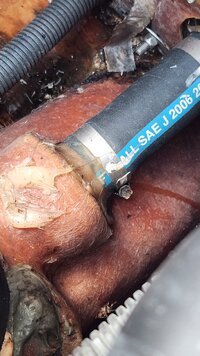

So while I was down there testing my scupper work...
Does anyone have a problem with this much water (just floating, not running. I did take around the no wake zone to see if it got worse, appears the same but without kill switches disabled i can't be sure) after about 1.5 hours maybe 5 cups of water in the bilge. Do you think I can just slap some 4200 on it without cleaning out the other stuff? (Port and starboard both doing it)
No.
You need to clean all that old silicone off and clean the surfaces well and re apply silicone to that area. I would not use 4200 on that. I’m impressed with the Gorilla brand of silicone FWIW.
Just “slapping” some more sealant on it means that leak is still happening at interface where it is leaking from.
No.
No.
I realized my question was ambiguous. What i meant was would anyone be concerned with that amount of water? I realized it could be taken as does anyone have that amount of water lol...
So after about 5 hours, and actually leaving the no wake zone for 15 minutes of 3/4 throttle, there is maybe a gallon if i was a betting man.. maybe a problem for the off-season. Along with the second bilge, rerunning my transducer, and some gelcoat work.
