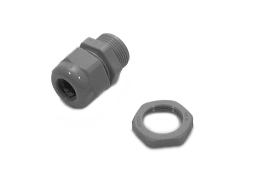

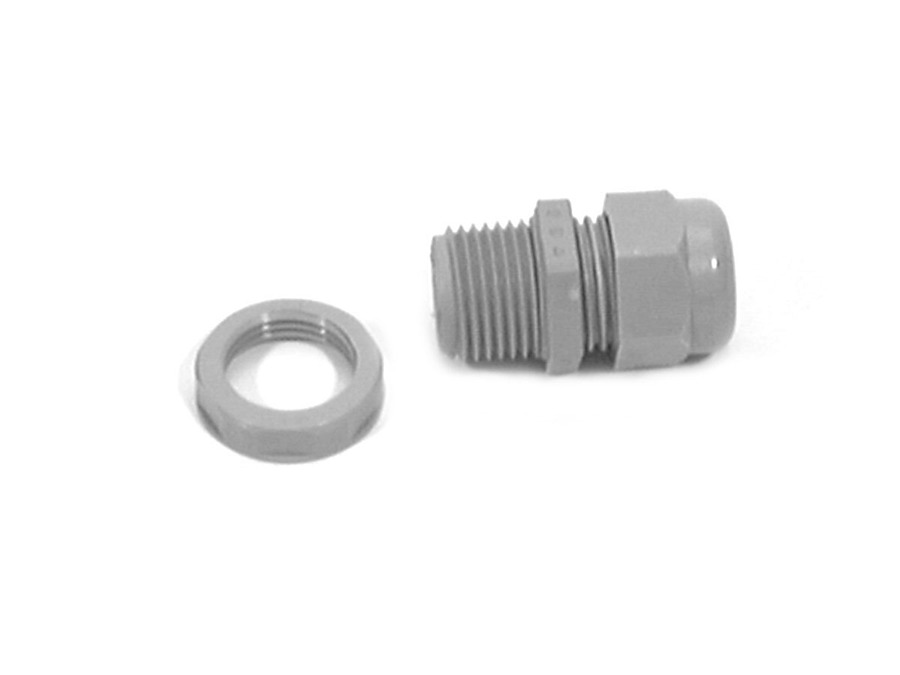

Hi, I posted my situation a few days ago - 1996 Regal Rush Broken Control/Shift cable. I was almost done but noticed the thru hull connector fitting was cracked. On closer inspection it came right out of the hole in the bilge wall. Without a good seal it will leak bad. The control cable goes through and is sealed with a plastic and rubber compression nut.
My dilemma is how do it replace the fitting? Do I remove the engine, impeller grate and/or ride plate? I communicated with Regal boats and the VP of products told me he is not familiar with the 1996 Regal Rush xp120 jet boat and would pass me over to customer service and highly recommended that I bring the boat to an authorized Regal dealer. I could not get any help locally. I’ve looked all over the net for photos of the bottom of the engine with the ride
Plate and impeller grate removed to see if I can see the rear of the fitting and if I could get a new one in and through the hole.
Do you have any photos of your ride plate removed?
Here’s what I got off the net. Any help is greatly appreciated.
