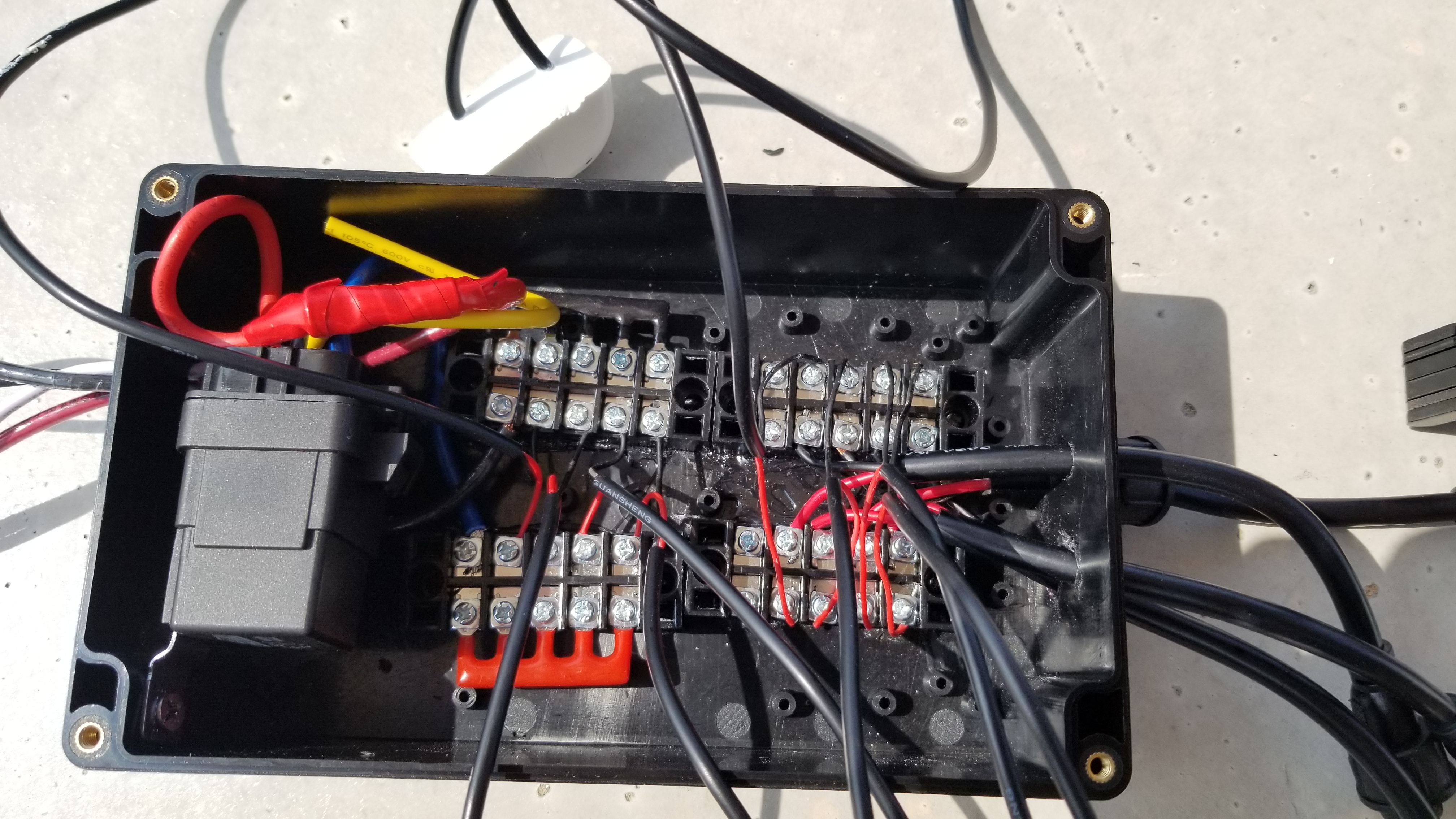

I decided to build a box to contain all of the electronics (really just a relay and led drivers:
I figured this would make it more organized than just soldering/crimping wires and drivers and leaving them in the bilge. I also thought it would be easier to troubleshoot and or replace components if need be.
Missing are the 4 led drivers that are stuffed on top of the wiring blocks (I forgot to take a picture):

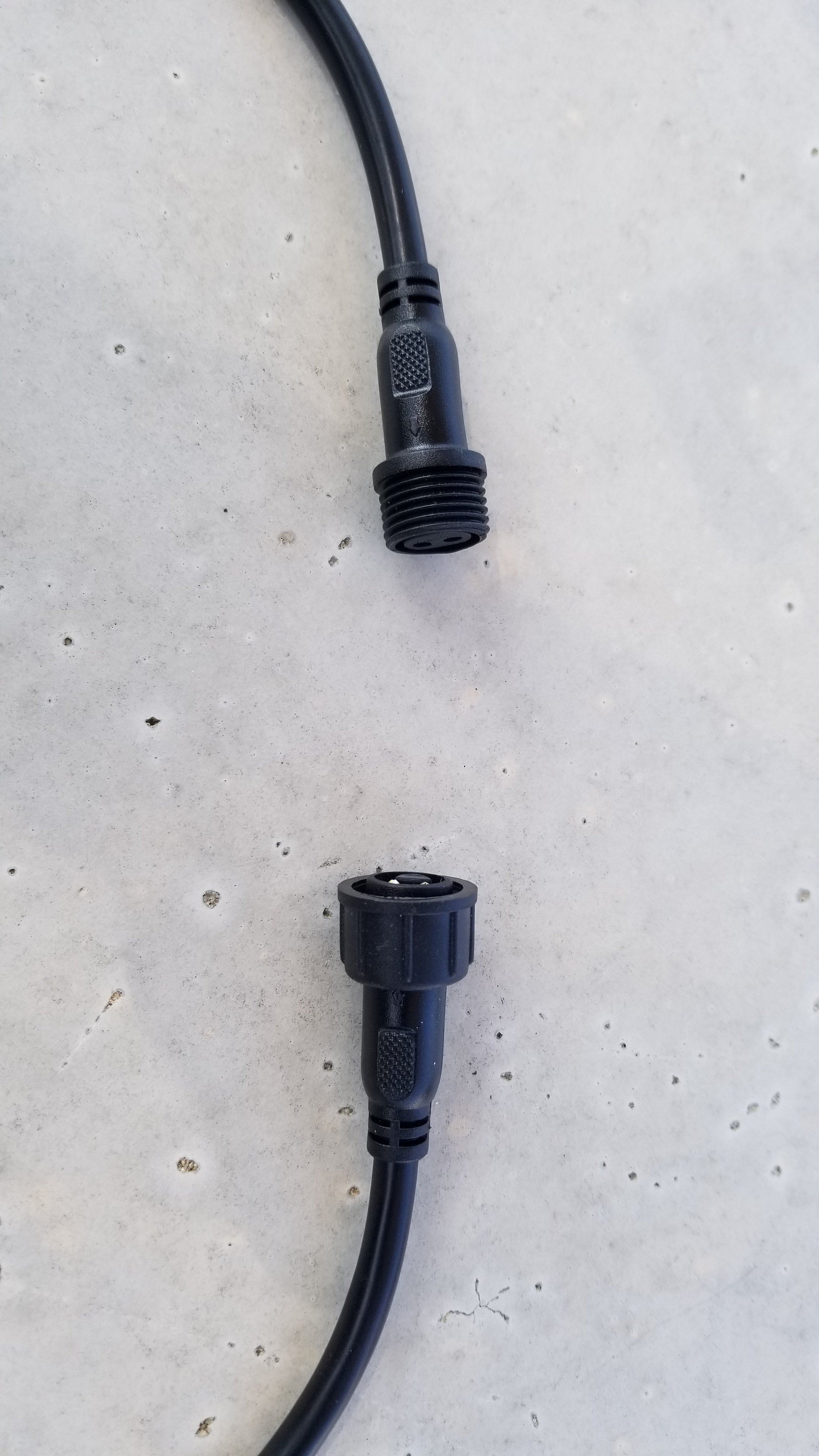

I also used 4 waterproof connectors to make the lights easy to disconnect if needed:

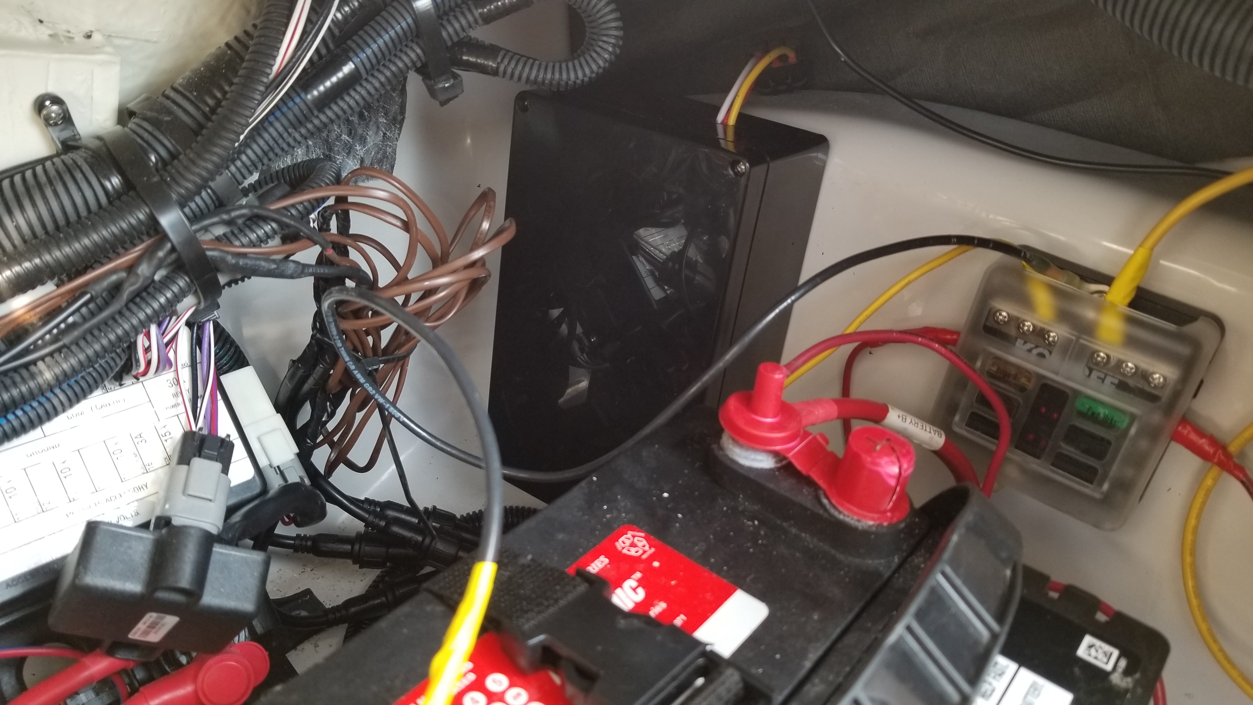

So here is the box installed (it's a tight fit behind the battery):

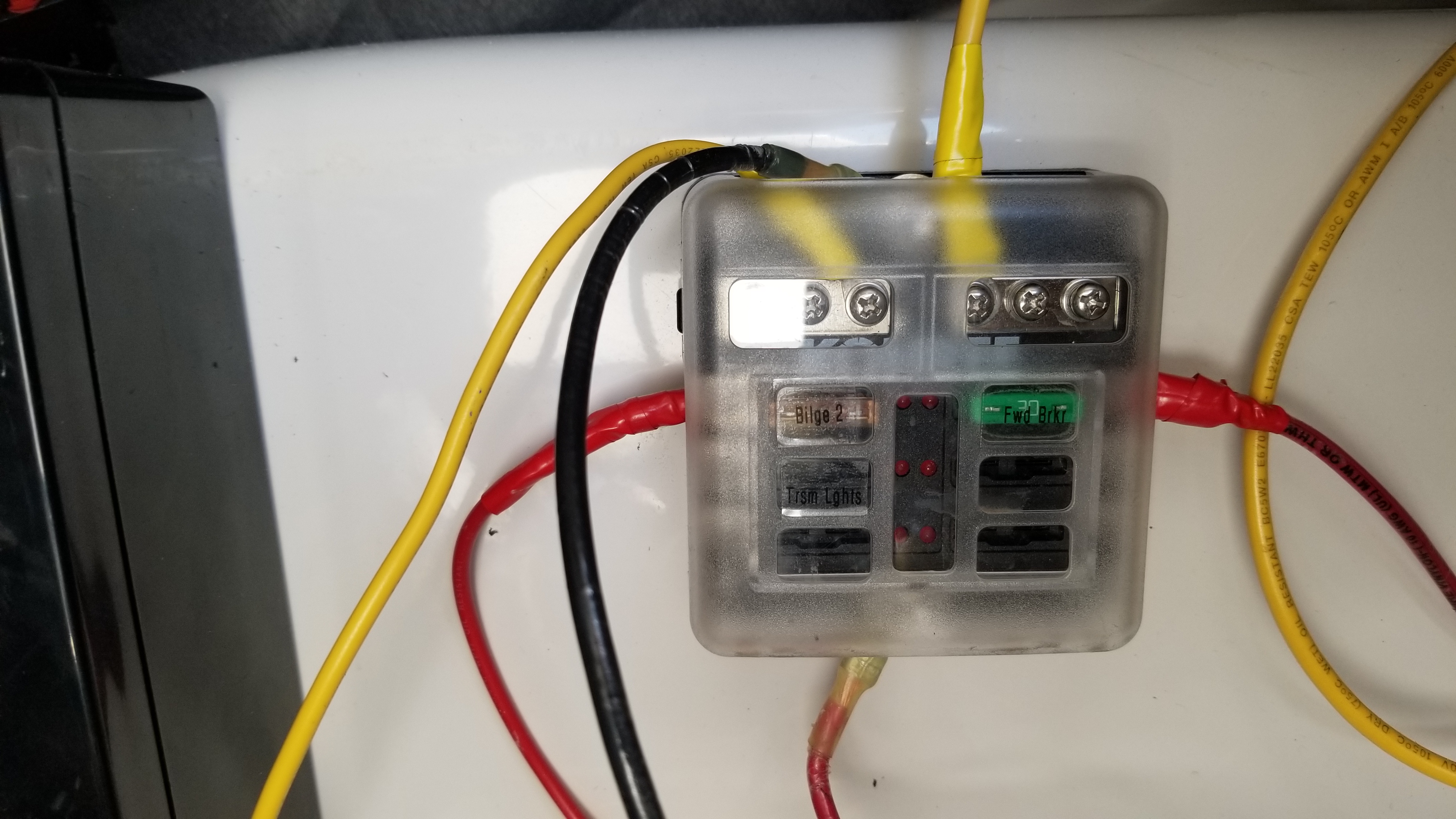

While I was there, I decided to add a fuse box because my battery terminals were getting full:
Scarab has around 5 things already connected to the -ve terminal. I had a secondary bilge pump and an accessory fusebox (for the forward marine radio) in the passenger-side console. It also makes it easier to locate blown fuses if need be.

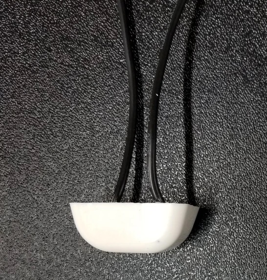

Nice light! Looks good. Be careful running these on plane. Mine (pictured below) burnt out and when I called the company they stated their lights are not meant to be used out of water. I asked if they sold any lights that do and (at that time) they said no. I noticed on their website they have a few additions to their collection so maybe they have some now. IDK.
Hmm... Thanks, good to know.
