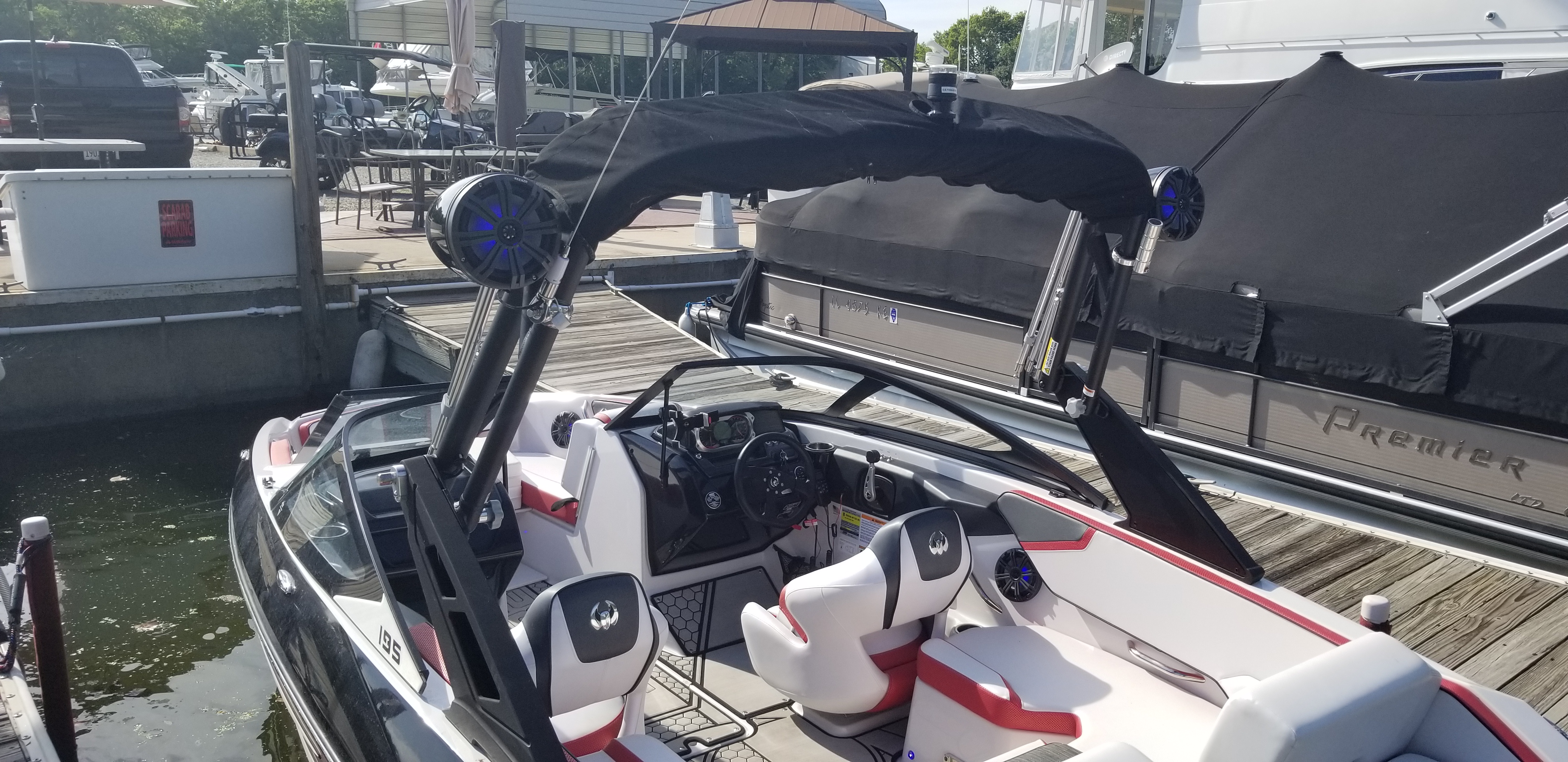

After our trp to the Michigan sand dunes...
... We decided that it would be a good idea to add tower speakers so we could more enjoy the tunes from the shore. Scarab's cost for the upgrade was $780. The identical speakers/enclosures on Kicker's web site were around $550. Amazon had the combo for $440! Amazon it is!
With a bit of help from this forum, I was able to install them.
Haven't tried the blue lights at night... Yet!
Now, I gotta get some speaker covers. Any suggestions?
