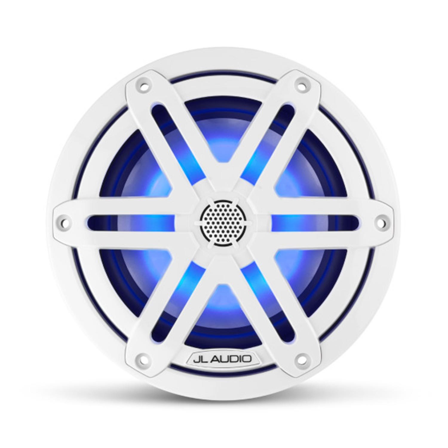

They are 5.5", we replaced all of them with JL M6's. The existing amp was fine (2021 Yamaha AR250).

We used these. Yes, stock wiring. There is a model without the LED backlight AFAIR
You only replaced the speakers?
I want to do the same, I was not sure if that would make a difference.
Did you do something else ?
TampaJet
15
13
42
They are plenty loud for us without an aftermarket amp.
