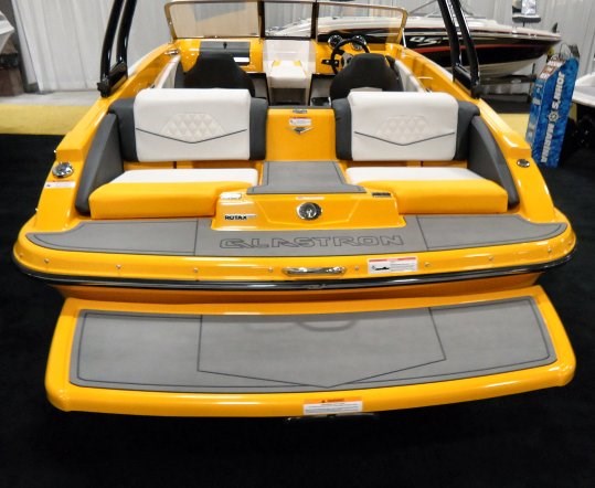

As I continue to build my own forum, I thought I would ask if anybody has seen a tow hook like this.
I can see what Glastron was thinking, in which a flush mount tow hook would avoid stubbed toes and such. Especially in an area that is designed for a lot of activity.
The issue is that using only the "finger" the tube rope becomes unhooked easily. When towing the 4-person tube, the rope is quite substantial.
When using a Larks head (or cow hitch) the amount of rope is nearly as wide as the finger. And a single loop, although thinner, seems even less substantial.
The major issue arises when my rope minder is working as we circle around, and tends to pull the rope off, so we need to reattach a lot.
Has anybody experienced a tow hook such as this?
Sorry for the poor picture, it is all I have currently. Hook is in the center. I will try for a better shot tonight.

Yeah, that is what I referred to as a "Lark's head" (how I learned it as a scout).
I will take a photo with the rope on it tonight. The rope was showing wear from only a single session, as this hook seems to be more of a "point load" than the standard style tow ring.
I am just trying to make sure I am not missing something simple...
