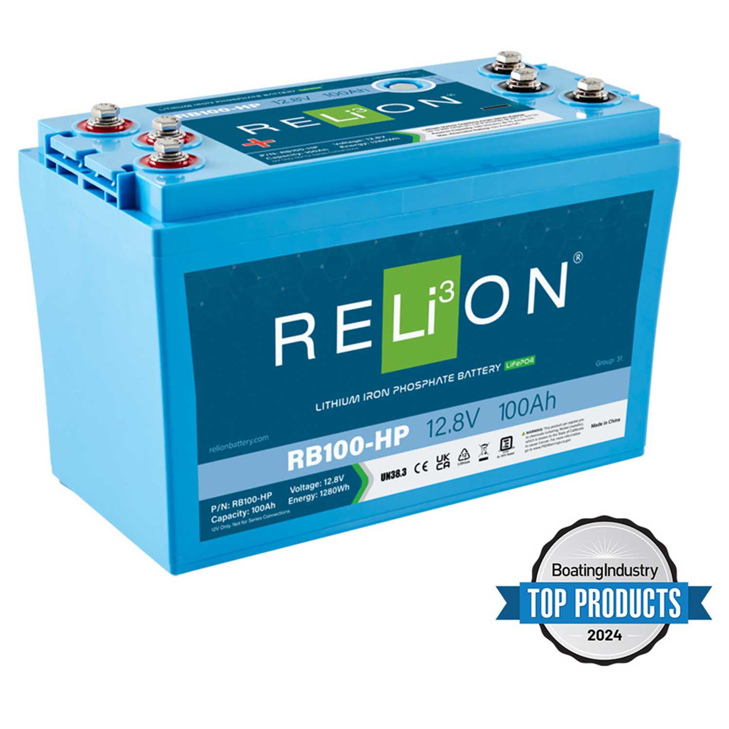

The ReLion’s would be a good choice. They have internally heated deep cycle batteries but you cannot connect them in series, but the non heated deep cycles can be connected in series. ReLion also has dedicated start batteries, both of these batteries can be had at West Marine or Cabela’s / Bass Pro. So, in the unlikely event you do have an issue you can just walk into their store to exercise your warranty. I don’t think their start battery can be hooked in series, not sure on that one. I had a long chat with the supervisor of their tech department, nice guy, when he didn’t have answers to the questions I had I heard him break out the manuals to find those answers, that impressed me.
Relion dual purpose 100Ah battery: $1,159
ReLion dual purpose 100Ah start/deep cycle battery spec sheet:
