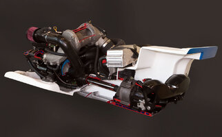

That is looking backwards from where the waterbox normally sits into the exhaust housing that has the cat in it... (let around the corner of that tube you see). That housing is raw water cooled. The raw water enters in the double walled exhaust system at the header, goes through the double walled cat housing and the exits at the end of the cat housing "around" the still "dry" exhaust stream into the waterbox... Here is a picture of how that looks:
The O2 sensor sits in the "hole" you see on the top, the raw water sprays form the 4 small holes around the center pipe piece, the pipe is the still dry exhaust stream. All together is inside the waterbed when installed. The clamp sits on the last piece of full diameter before the pipe gets smaller. . It's all very short, so that part of the exhaust ist basically constantly in a "raw water fog". Even on a brand new boat as far as I understand. While the boat is running, the exhaust pressure basically blows away that fog yet swirls will still be there (it blows into a box full of water) and the moment the engine stops, the warm/hot waterbox condensates in the actively cooled and therefore cooler exhaust housing. At least thats what I've been told and technically (I am an engineer) that makes total sense. So to sum this up, I think my scenario is possible without a leaking cat housing yet I can't rule that out completely yet.
Here is a good picture of the Rotax JPS system with cutaways:
