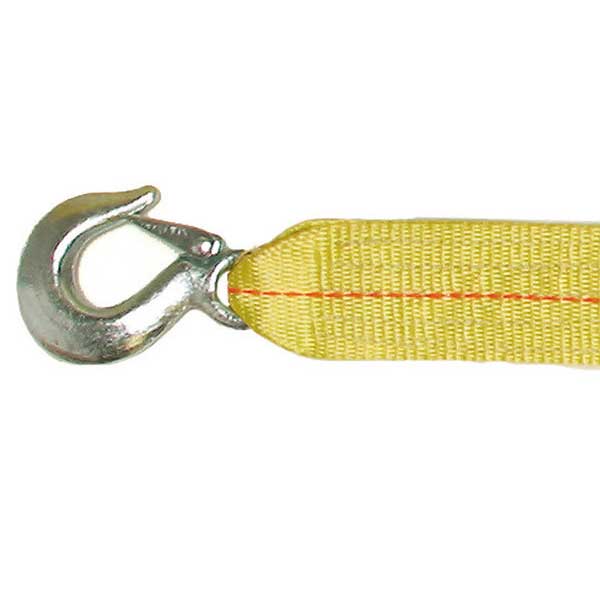

We trailer to the lake typically 2-4 days per week, so the bow wench strap gets a LOT of work. We power on/off so it's not getting a ton of cranking force, just snugging it up. Just snapped the 2nd one in 3 seasons. It's snapping at the seems near the clasp.
Any recommendations for new bow wench strap that will be durable and could trust, those stock nylon ones don't seem as capable as they should?

Great question! The stock straps seem very inadequate, I'd hate to see them get maximum use and how long they'd actually last/handle. Tonight, I ended up getting the 5,500# boat buckle 2" X 25' wench strap that has 8k breaking strength from West Marine, a bit thicker but much more heavy duty. Surprisingly, all 25' actually fit on the wench too.

If you're breaking straps at the stitching, and not using much length, then you could potential "double wrap" the strap and let the clasp just float on the mid section of the strap. Would give you a stronger connection since you would be relying on the strapping only, and not the stitching.
