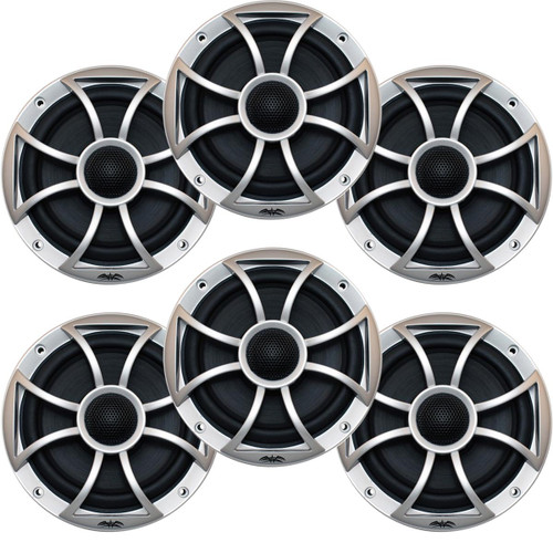

I also just saw this wetsound package.
Again, look into getting a quality marine grade amp. Buying better speakers without having an amp to push them is not fixing your issue.
