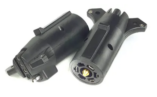

I use an adapter with where the 5 wire connector plugs into one end and has the round 7 wire connector that plugs into my truck on the other end:

Here’s a wiring diagram for the seven way that is on your truck, your five to seven pin adapter will connect the five wire to the seven wire according to the diagram. But in the case of your boat trailer you will not have the 12V aux power or the trailer brakes.
The white wires will be connected together at the same pin location which is ground or common.
The brown wires will be connected together at the same pin location which are your marker lights and tail lights.
The reverse lights which are purple on the new plug will be connected to your trailers blue wire to activate the solenoid for trailer brake bypass.
The rest is self explanatory.
Use a test light or a multimeter to assure the correct wiring location on your trucks seven pin connector before wiring up the new plug. I’m kinda with @Babin Farms and I’d just wire in a seven way plug but the adapter thing will obviously work just fine.
