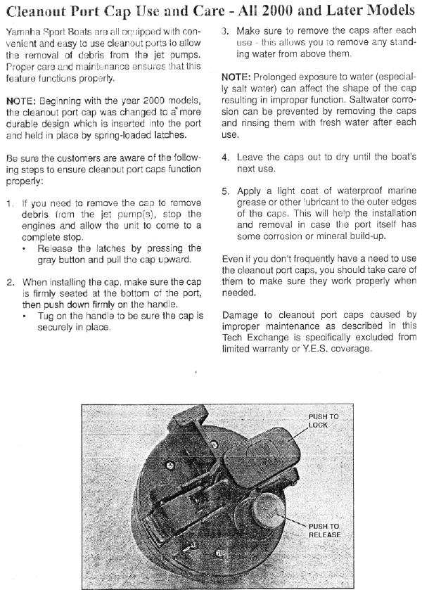

My boat is 11 years old, I don't lube the plugs, I have no reason to believe that they were lubed before me, and I have zero issues with the plugs. Using Cobra EZ Locks here. I see no reason to use lube on plugs. If you NEED lube, they're probably defective anyways and should be rebuilt IMO.
It would be interesting to see the year and model of boats that have suffered blow outs. I wonder if it's an age issue, meaning more plug failures occur after they are 3 years old or older. Has anyone gathered any data or know of any statistical analysis done regarding blow outs?
I'll go on record as having had a blow-out when the boat was probably 3 or 4 years old. And I'll take credit for having not seated that plug properly. I learned from that mistake.
I started keeping nerf footballs in the tube to lesson the impact on the hatch should there be another blow out. (I only have one now, some rat faced git stole one)
I meant to do something to prevent it from happening again, like adding a lock of some sort. I never did.
I leave the plugs in. All the time. Except to remove debris from the jets.
I cleaned them with a wet microfiber towel last Saturday. They were a little grungy, but not bad. I never have lubed them. I just clean them. They may get a bit tight, but a little rocking motion and they come right out.
I'm on my 12th season with this boat and these plugs. I most likely won't change my ways now.
