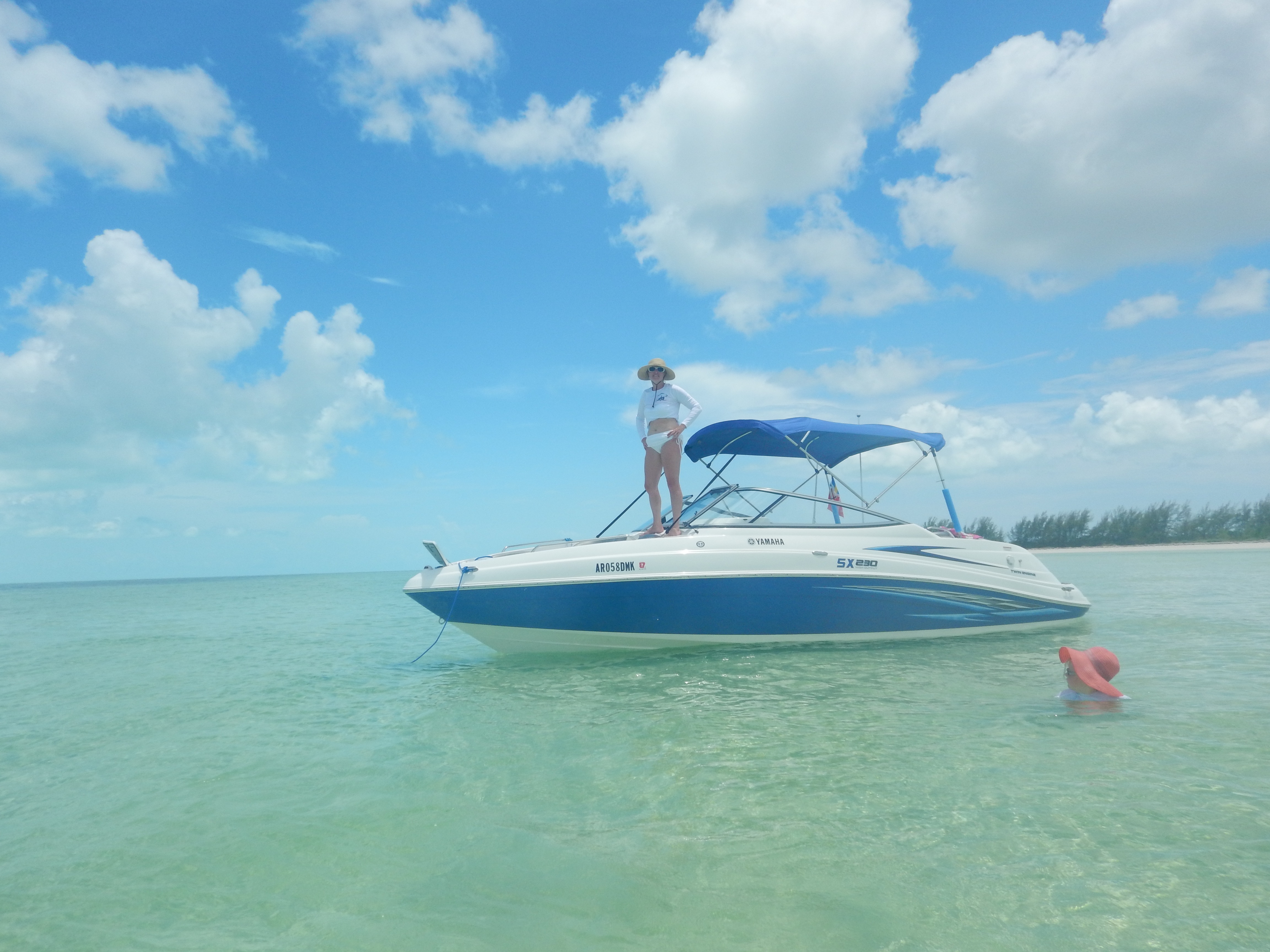

We live on a 1/2 mile wide by 1 mile long bay that is mostly 4' deep. We can ski, tube, kneeboard and surf in the 4' and sometimes less of water without any problems. I would not be concerned about 3'. The only issue is that running sand through the Jets will cause wear but that is the same for wave runners.
We have a keel guard on our bow and occasionally will beach our boat. But with the swim deck and lack of props it is much more convenient to have the stern facing the beach for easy access. So we typically drive toward the beach / shore spin the boat around, toss the bow anchor with a stretchy anchor buddy line attached then back into 2' to 18" of water. At that point I step off and either set a stern anchor on shore or tie to a tree. I keep the boat in water just deep enough to avoid the fins touching the bottom while everyone unloads then I loosen the stern rope and allow the anchor buddy to pull the boat out a little so that disturbance from waves is not an issue.
Here are a few examples.
