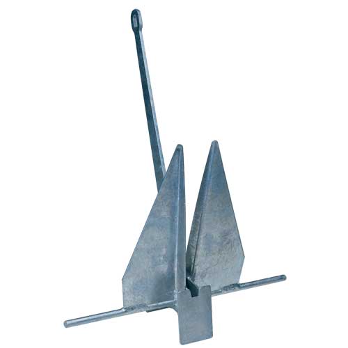

This is the first anchor I bought. I used it in my local lakes with great success. It is now my stern / shore anchor.
