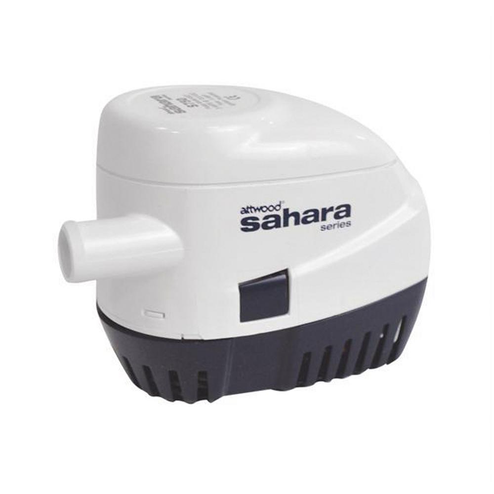

They definitely change suppliers from year to year and maybe model to model. The pump in my 212s is oval shaped like this one, but not sure of the brand without checking:
Pump
The bilge pump in your boat will most likely be a Rule pump. Just stick your phone down there and take a photo and order one online.
