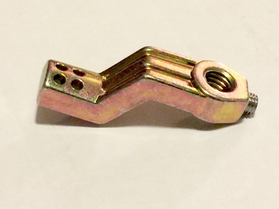

It could break the latch on your hatch. If so, you may need one of these.
