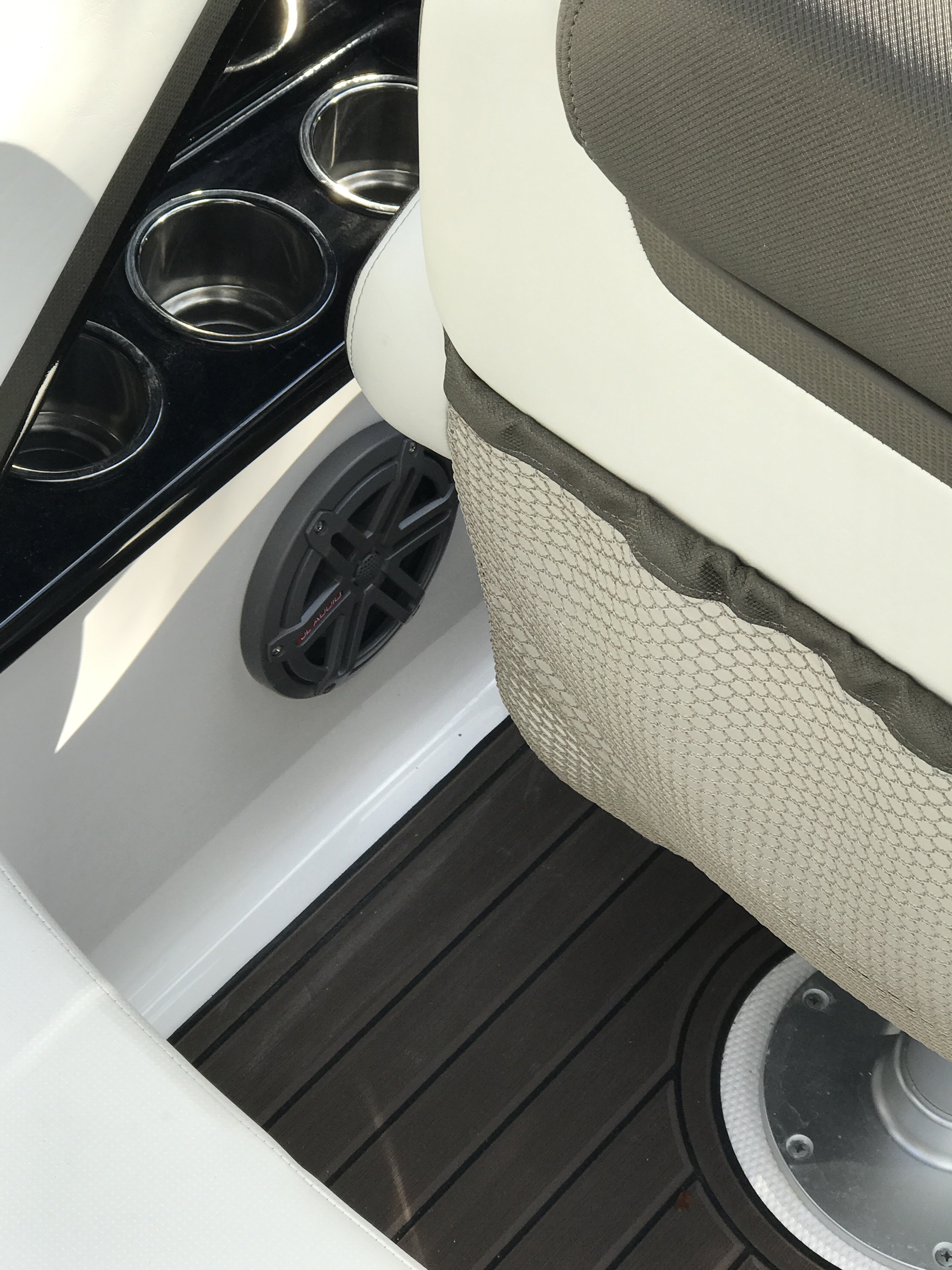

Here's a picture of mine. :)
Also keep in mind that you can buy colored spacer rings for these speakers if you need a little more clearance. That said, I didnt need one on either side. Just watch out for the cleat backing....I posted photos of what is back there....@ me if you dont see them in that thread.

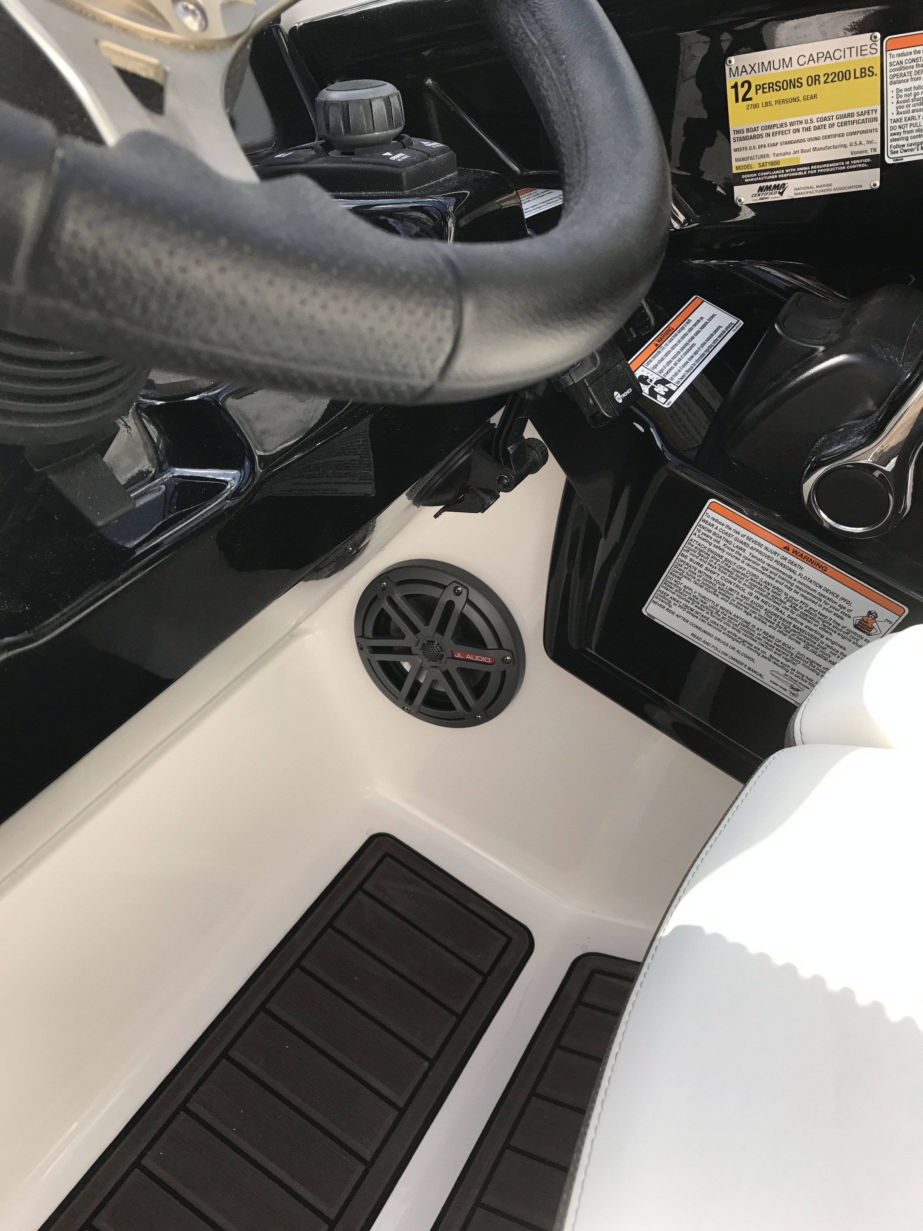

I wished I would have mounted my cabin speakers higher like others have done, but in this location I mounted these JL 6's I believe I have room to put 7.7 there, pretty deep

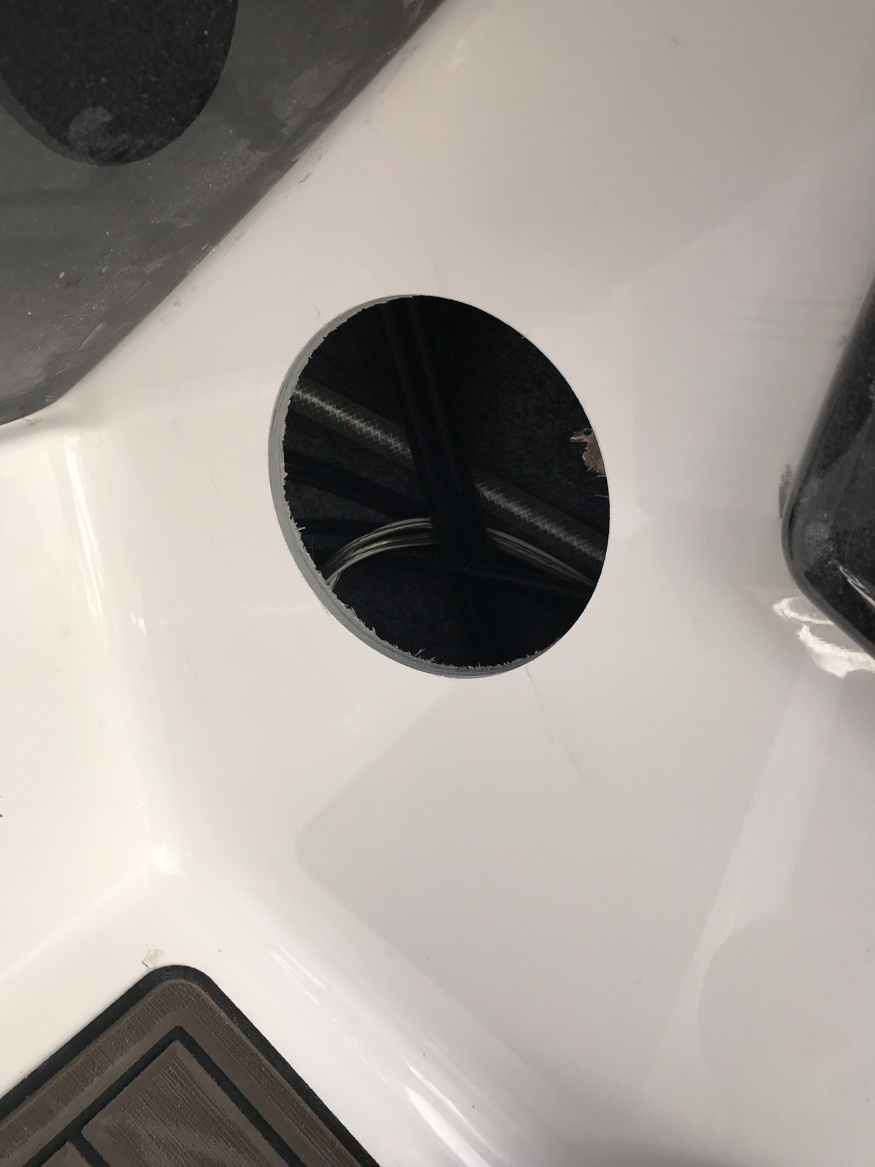

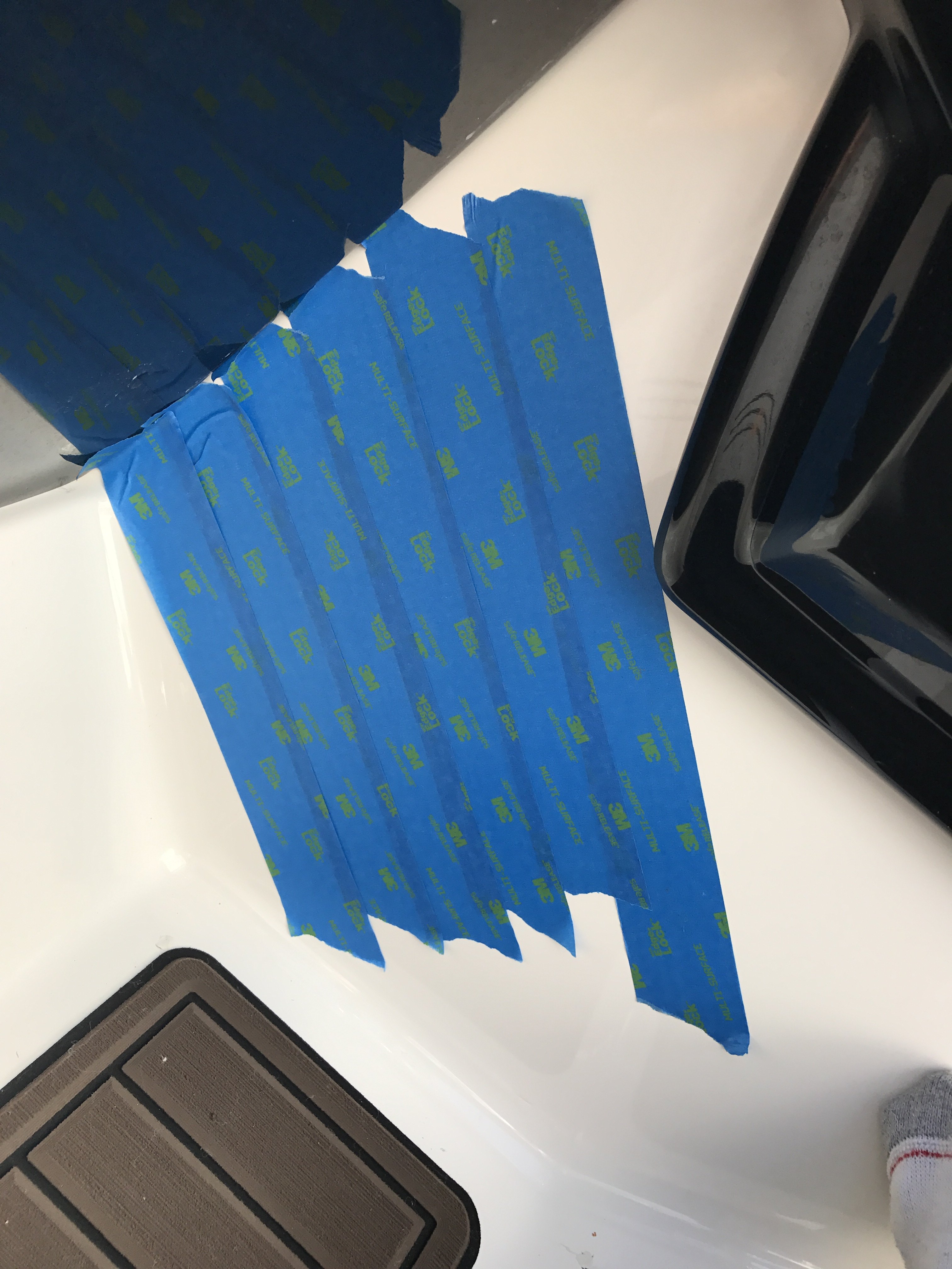

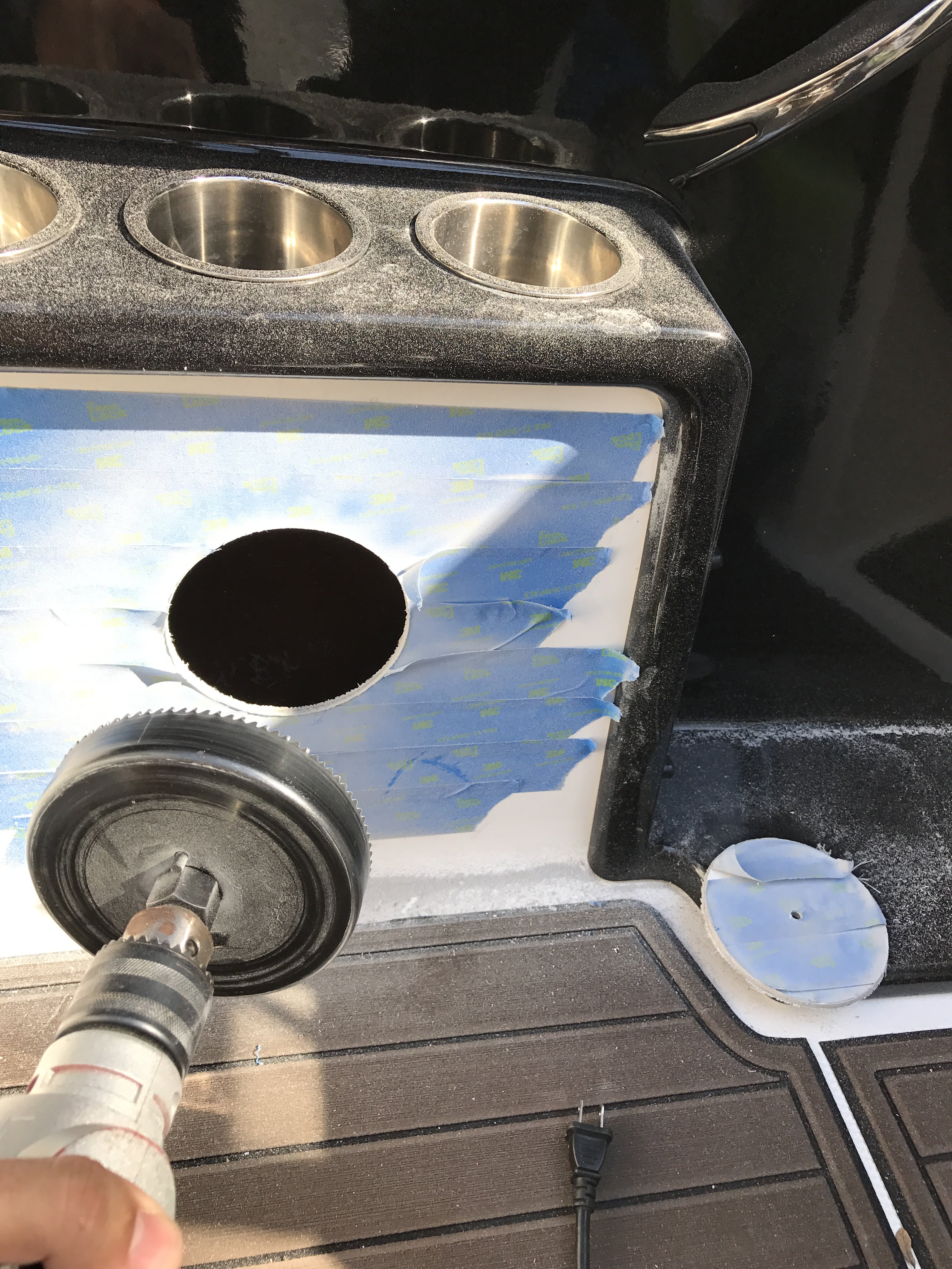

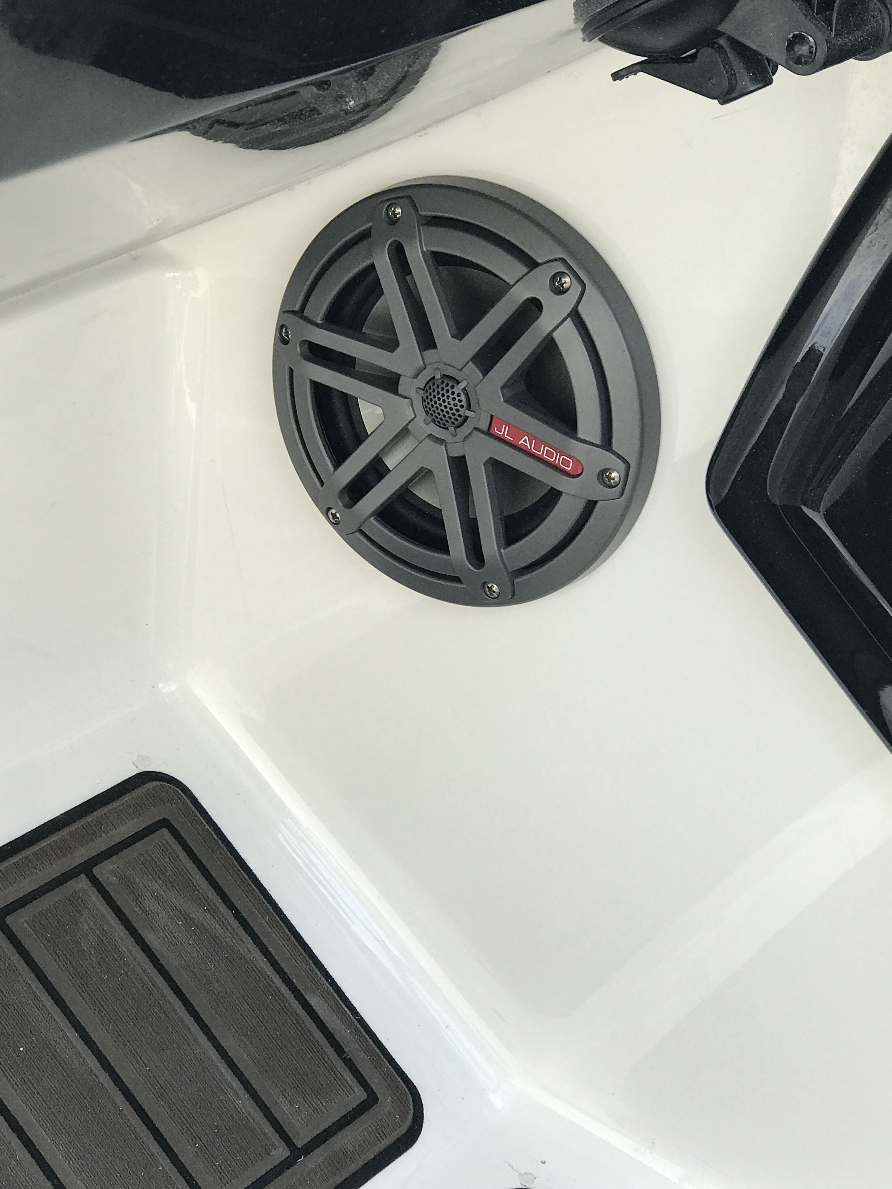

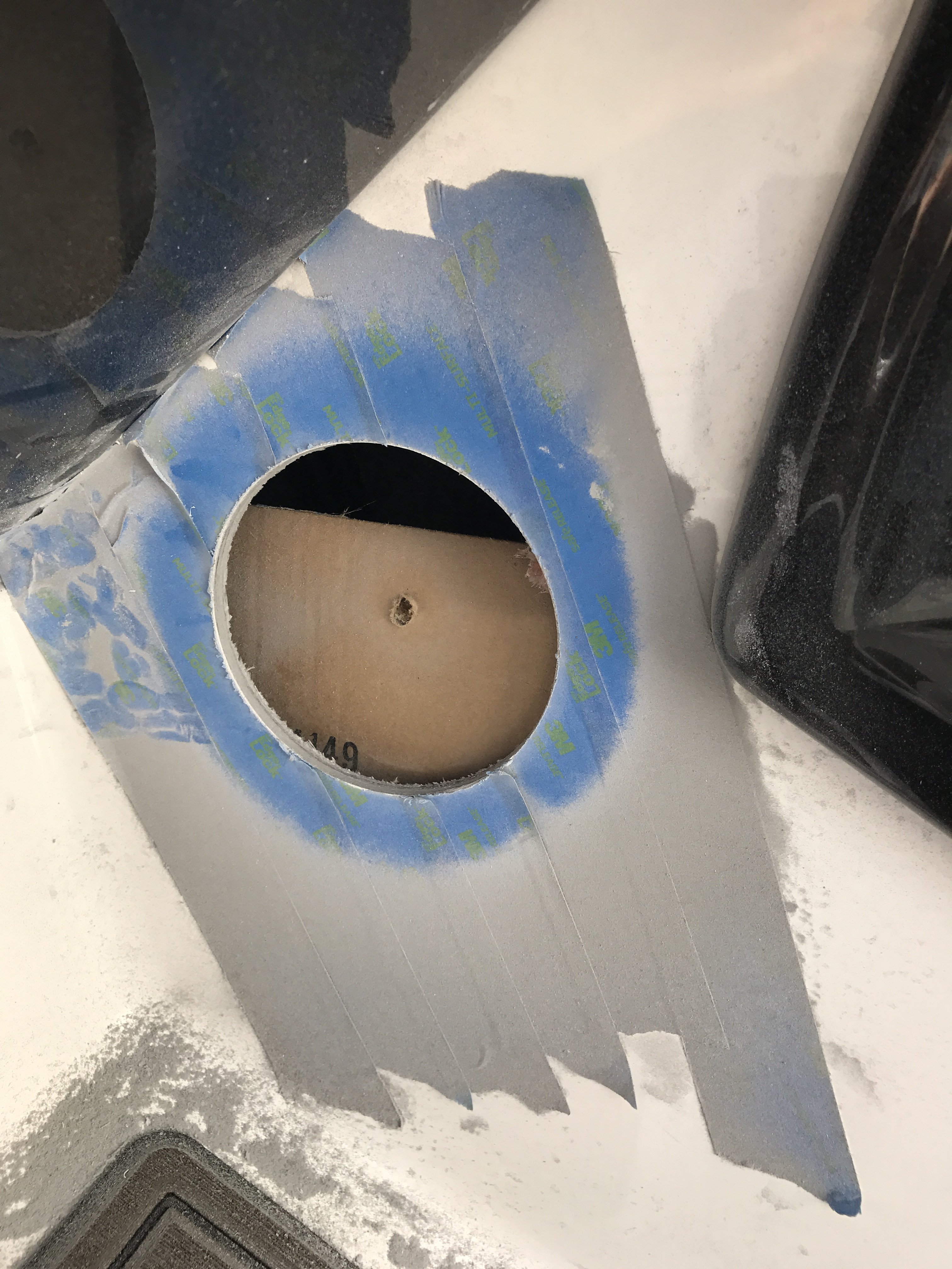

Driled the holes today. What a mess. But I'm on the lake with great sound while driving.now I have to get at the big sub hole next. I had to get another amp as well. And learn the proper way to wire it all. I've got 13 channels on 3 amps and lots of bridging. I'm sure they make a nice volume controller for front mid rear tower. More ml time and money. A good installer would have suggested all this and took my money. But that guy sucked.
Looks like I'm going to have to re drill the mounting screws for the port side. After sitting here looking at it a while, its crooked.
