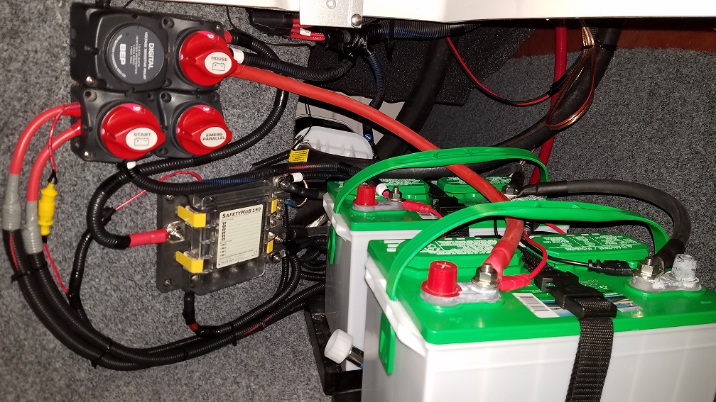

Previous owner left a little bit of a wiring mess (and an un-fused 4 ga amp power cable!) on top of the OEM wiring that leaves some to be desired. Cleaned everything up using a SafetyHub which should make adding anything in the future easier and cleaner. Now I've only got 1 large cable and the onboard charger leads attached to each battery post. I'd like to put the batteries on a sliding tray to open up the storage but that'll have to wait for another time as I've got a CARB boat and have a charcoal canister and vent line in the way to relocate or remove.

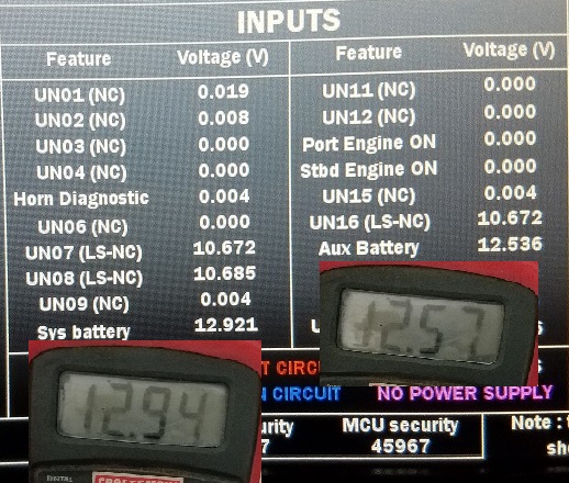

Did the Connext voltage fix while I was into everything as well. Voltage reads independently and accurate now, within a couple hundredths of a voltmeter at the battery.
I think they all have it, mine does and is not a CARB. I moved mine further up front and up - under the cap below/behind where the rear tower leg attaches. Needed to make room for ballast bags.
