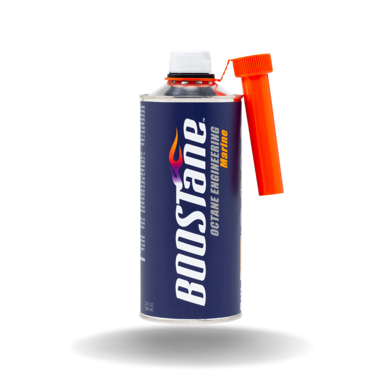

I've used the Yamaha fuel medic mixed a little lighter than the recommended blend since new. Ethanol pump 91 octane .
Spools up a touch quicker if I dress it with a tiny bit of this stuff, their formula brings it to 93 octane...
