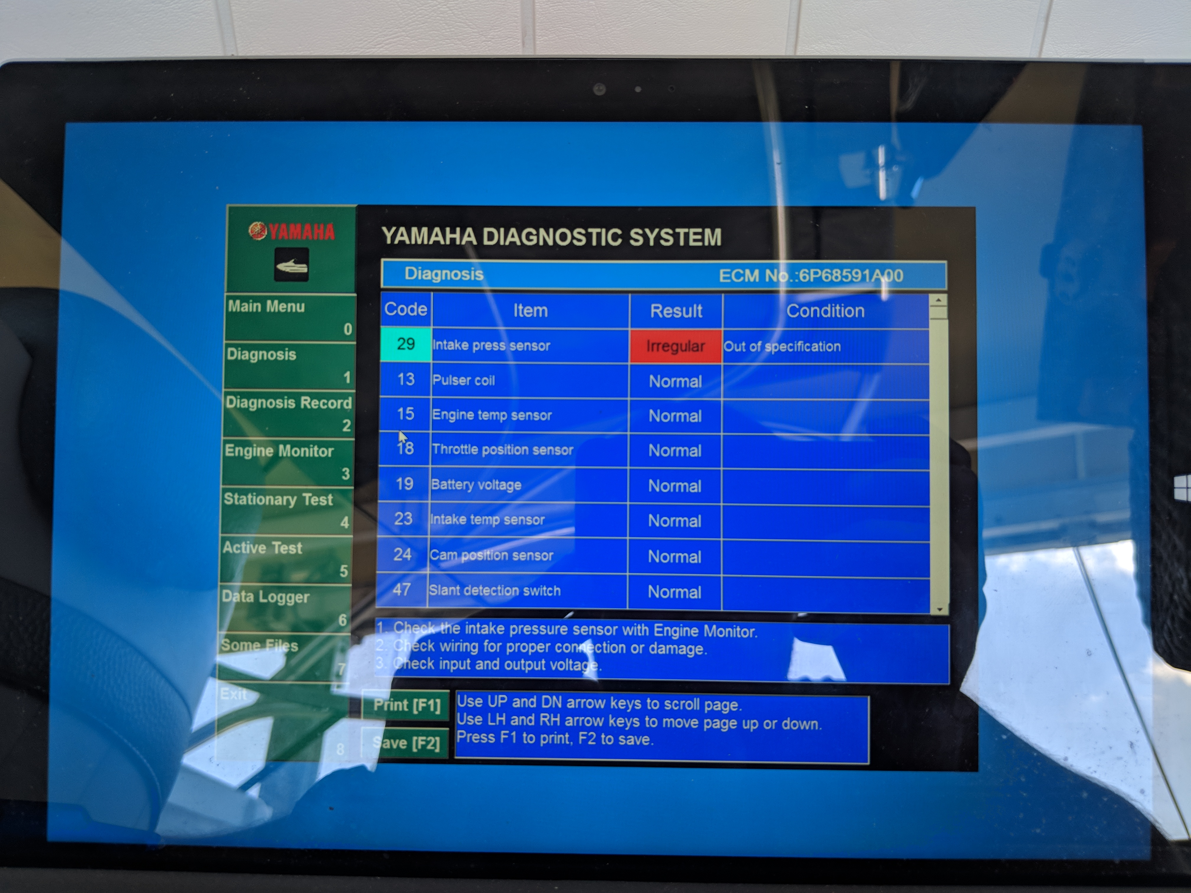

I've really taken to trying to learn how every little nuance of the boat works (mainly to calm down my OCD/PTSD from the blown engines :) ), so I got the Yamaha YDS software to get extra preemptive with my maintenance.
Out on the bay last week I got a temperature warning, I've gotten this warning once before.. but just figured I had an obstruction or some debris. Both times I've gotten this warning it went away after I switched the engine off and turned it back on, so it lends a little credence to minor obstructions. When I hooked up the YDS software I got the "Error 29 - Intake Press Sensor". I ordered a new Intake Pressure Sensor from ebay for like 55 bucks, but have yet to see exactly what purpose this thing does. From some google searches it seems like it helps control fuel injection at low RPMs, is this true? The motor seems to be running just fine, oil levels are good, however it did get a tad bit finnicky at lower RPMS, so I'm thinking this may be the issue. By finnicky I mean when I first got the engine back it would sometimes immediately die after I fired it up, or the RPMs would fluctuate wildly (then they'd settle down after a few minutes of operation). These issues seemed to have remedied themselves after I toyed with the ICV. The new engine was at 300-400 less RPM's than the port side, but the ICV tweaks fixed it.
5D1dRG7
Long story short, anyone have any experience with this error code and can you tell me exactly what this sensor does? Other than that, the boat is running great.
