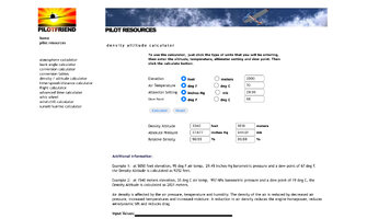

@Neutron asked you above to provide altitude, temp and humidity, those three things combined determine density altitude which greatly affects your engines horsepower output. You can see from the pic below that at 2000’ of elevation with temp, humidity, temp and altimeter your density altitude is 3340’ which is a hp loss of 10%. I don’t know your exact location so I had to take an educated guess as to the specific conditions.
I explained in another thread that there is an available power / reserve power and jet pump demand hp curve. Where the two lines meet is going to be the maximum rpm of what your engines will turn
Your engines do not make peak hp until they reach 8000 rpm, at 7200 rpm your engines are producing less power and thus the sooner the available power and jet pump demand power meet which results in less water velocity and volume being produced which equals less boat performance.
As you can see from this Berkeley jet graph the demand power is not linear, it increases logarithmically, so again, it is vital that you get your engines up to 8000 rpm and the only way to get there is to reduce the demand of the jet pump by reducing the pitch of the impellers.
Your boats engines output is 111 hp each at sea level under standard atmospheric conditions, and the jet pump demand is designed for those conditions. Since your boat is at higher elevation you have to change the design of the jet pump demand by reducing the pitch of the impellers. There is no greater performance enhancement you can do to your boats performance than having a set of tuned impellers for your boat that are set up for the altitude that you are boating at. Also, the impellers need to have a slightly different pitch between the port and starboard side due to engines spinning the same direction, with the impellers tuned to each side of the boat the loading is the same on each engine and this also increases performance.
