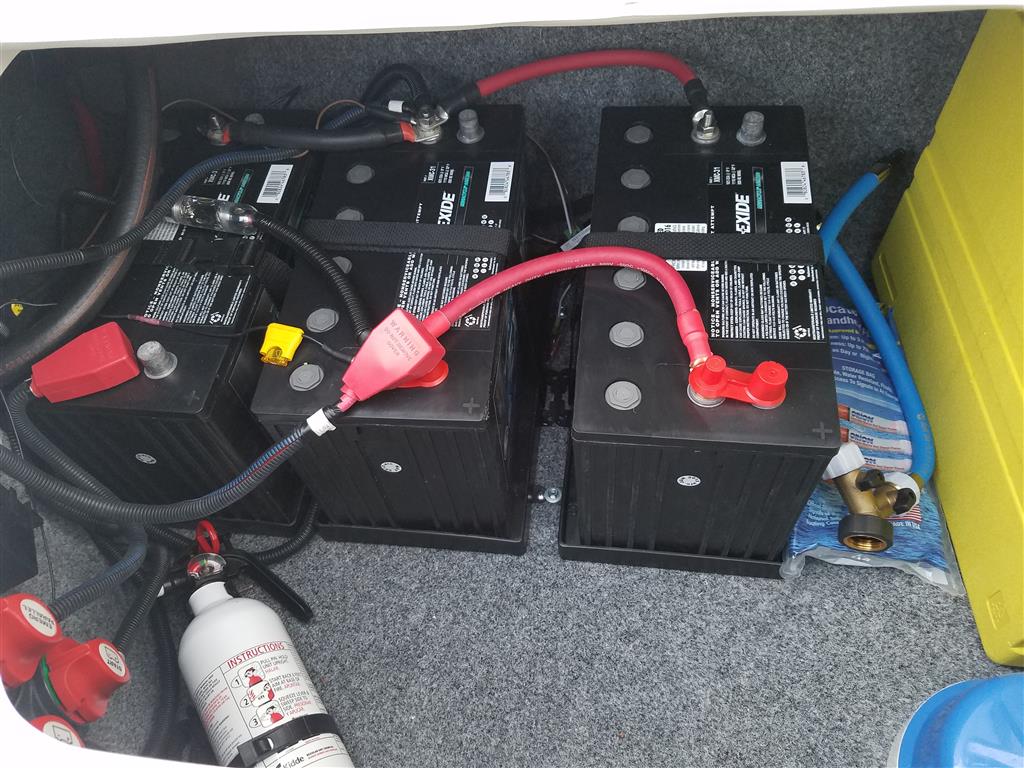

I got these from the interstate store a few weeks ago. Most cca and Mca available in their standard group 24 batteries. About $130 each after sales tax of 10% but before the core charge is refunded. I couldn't bring myself to buy the optimas and assumed that interstate's equivalent would be just as much. At least these are brand name, unlike the ones that came with my boat. However, I used to replace my boat batteries every two years no matter what with Walmart branded batteries and never had an issue with them until their prices became comparable to brand name batteries. @txav8r suggested I return them for deep cycle batteries but I decided to stick with these, I like the specs/price plus when I told the sales rep about my use and that they at connected to a charger maintainer when ever the boat is not in the water he said I'd be fine with these. The deep cycles were th same price I believe.

I bet that touch screen is expensive. I would be taking it for a warranty claim ASAP. This is the first time I have heard of issues with one.
Bruce
13,332
13,426
857
Royal, AR
That solar panel is quite expensive for it's output. 8.3 watts is around 2/3rds of an amp. If it is well positioned it might produce that for four hours a day.
Your group 24 batteries are around a 60 amp hour capacity. If you were to discharge them to 50% two of those solar chargers would need 11 days to charge them to full capacity.
They may serve you well as a maintainer but if that is what you want I would look at sub $20 products.
Were you aware that your batteries are cranking batteries and not deep cycle. Our starters are small and place a small load on the battery. I use two deep cycle batteries so I can discharge them without causing damage.

If these lasted 2 summers then I will just plan to replace them that often. And with a solar trickle charger (even if only a few hours a day), it might extend the life. I don't have a power outlet by the boat is why I can't use the plug in ones.
