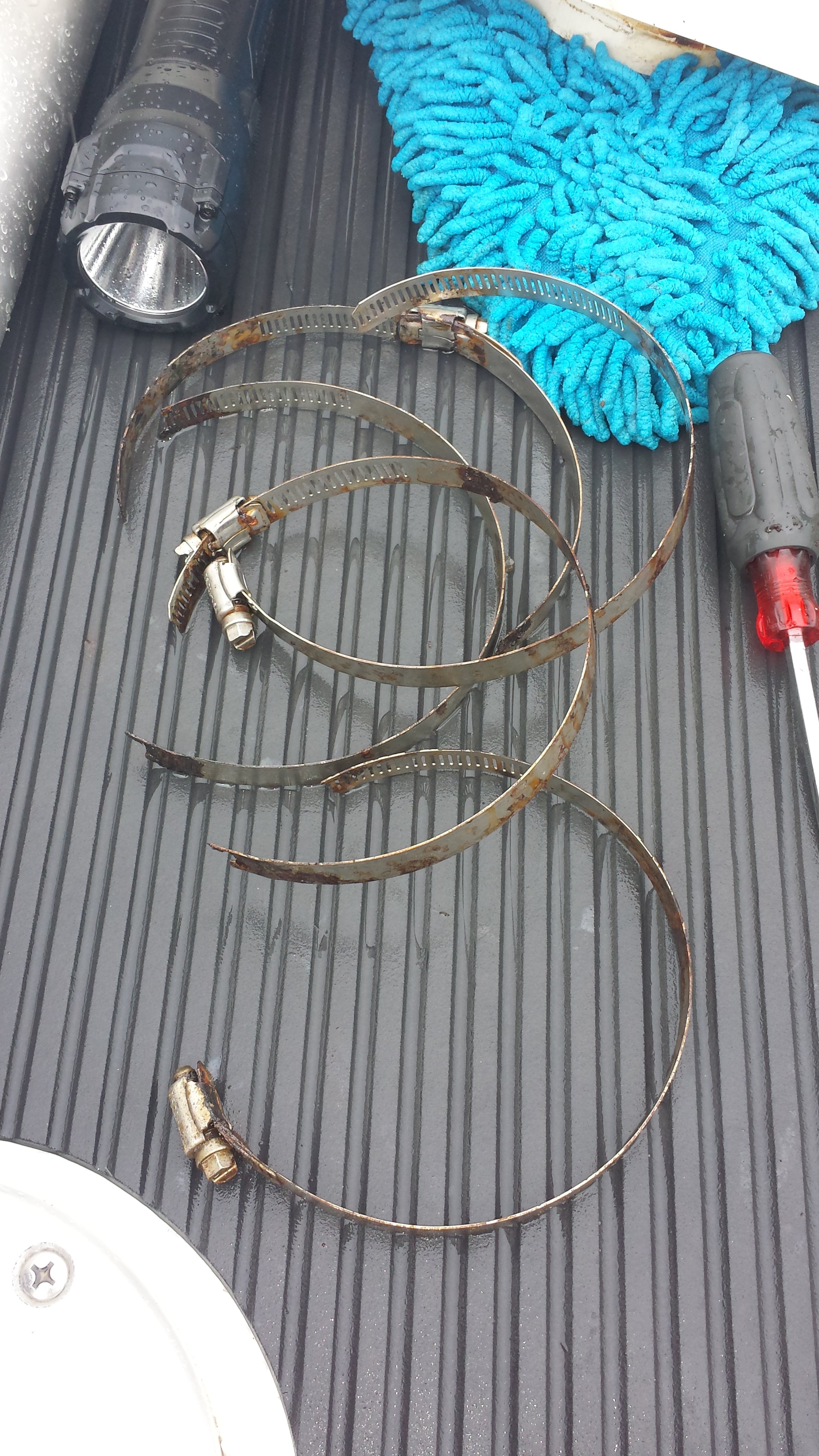

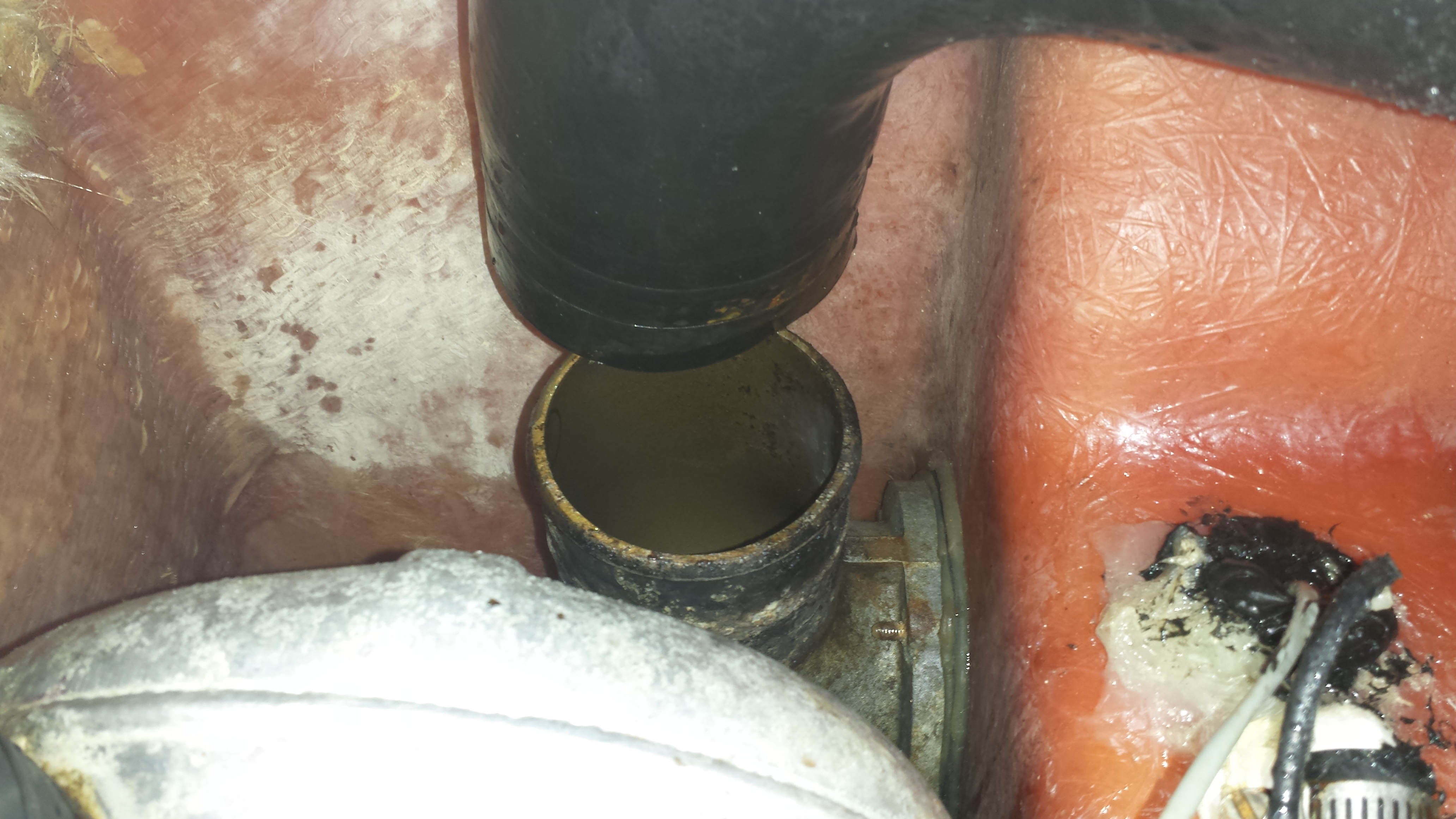

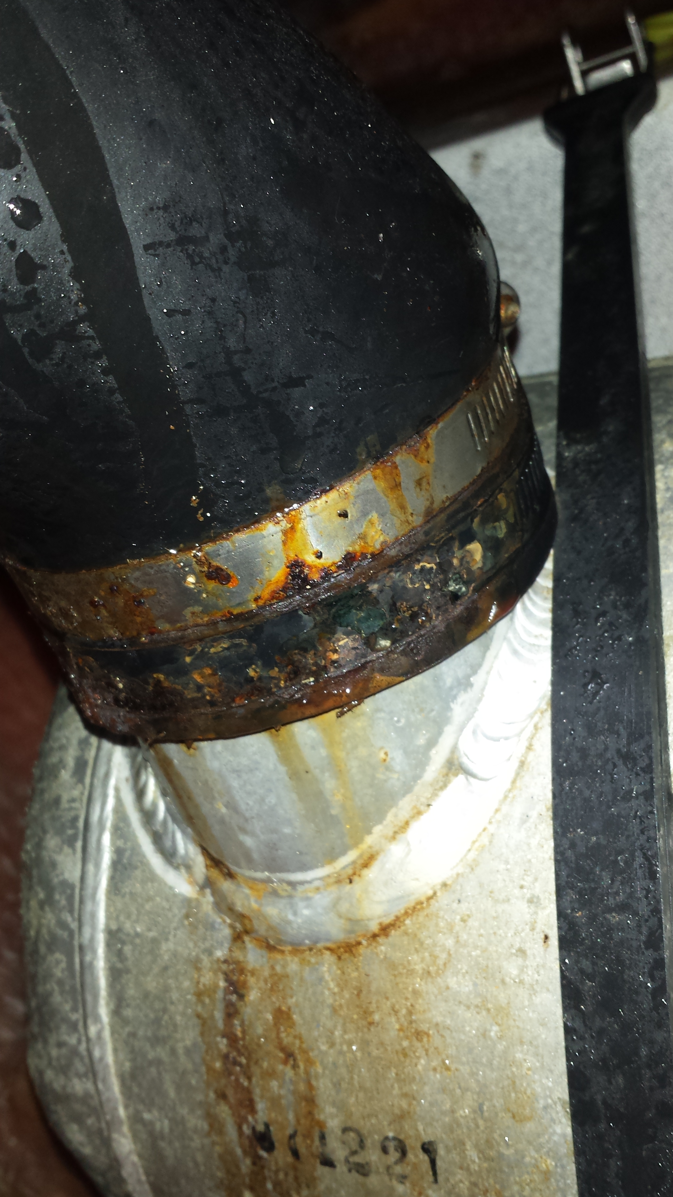

I quick look through the inspection panels in the clean-out tray immediately revealed the problem. The hose clamps on the muffler water box to exhaust output (elbow) on the port side were missing and the hose was completely disconnected allowing water to pump into the boat at high power settings… practically a four-inch hole in the hull. This explained the water in the engine compartment and exhaust fumes... After removing the clean-out tray cover I found over half of all the hose clamps in this compartment either missing or at the point of failure due to corrosion.
Folks… when this happens, the boat fills up quickly. If it took a 750gpm pump almost an hour to evacuate the water… I think we can all do the math and figure out how much water must have been in the boat.
The sound of incoming water I initially heard was because, at the time, there was enough water in the boat that the top of the bulkhead-mounted exhaust fitting (elbow) was below the water line and water was flooding in. We were dead in the water for almost 10 minutes at that point. Had I not been able to get the bilge pump running, along with the manual bailing, I am sure I would have lost the boat.

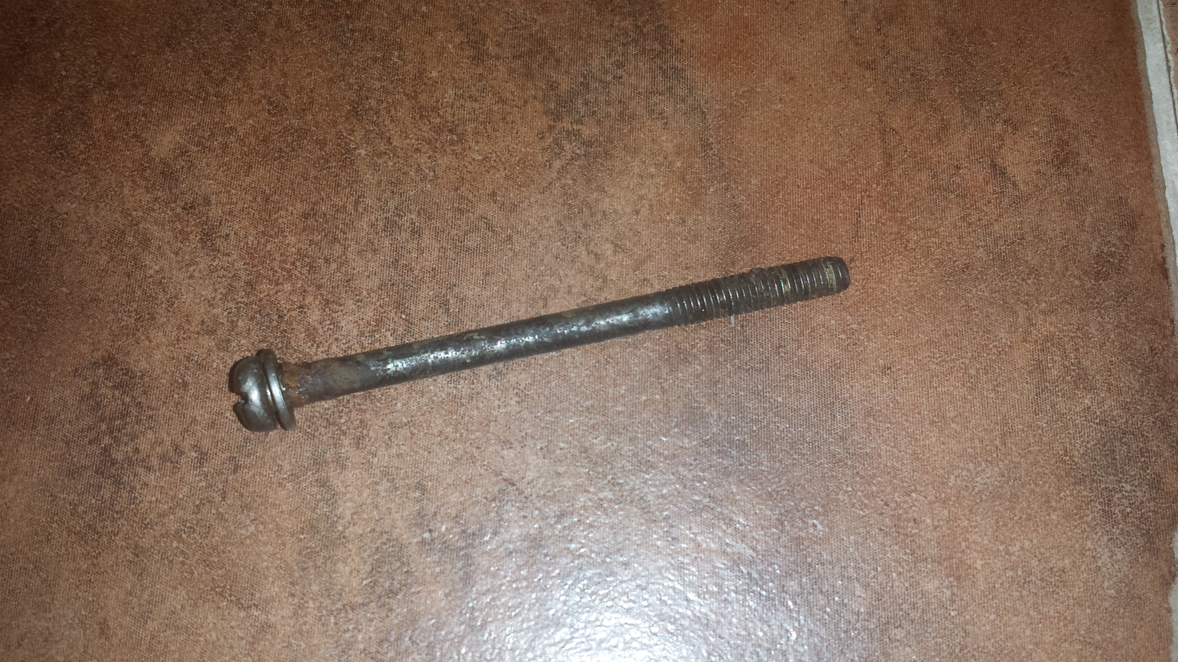

Oh yea… I found this screw under the scupper when I removed it. No idea where it came from and I can’t find one like it in the parts manual… if anyone can identify it please let me know.

Inspect, at least annually, all the hose clamps on your boat. Two corroded $4 clamps almost sunk mine… I dropped my guard with respect to preventative maintenance because everything always worked, and I never considered the importance of the clamps under the clean out tray. Something I would have paid more attention to had I kept up with the forums, and something that I will never ignore again.
