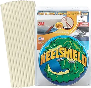

I had a chunk ripped loose, and re-glued with 3M spray adhesive to get me through the season. Or at least until I found another deal on a new guard. It held fine, but the original adhesive is the best. Heat can help get it set as well.
If you need to figure out if it is a Keel Guard, or keel shield there is an easy way to tell. One has ribs from front to back. The other is tapered and smoothed on the leading and trailing edges.
Gator Guard Keelshield is ribbed to the edge. I have installed two of these.
Megaware Keelguard is tapered and smoothed. I have installed one of these. Both are about the same for install. and removal.
Good luck!

Also, it is common for keel guards to come loose. What I did, as others have, is when I put my Keel Gaurd on (Gator Shield), after I was done I used black 4200 around the outside which sealed it to the boat that way no water or water pressure can get in there and start peeling it off. just put a small bead and run your damp finger or a plastic tool like you would caulking molding and it works great.
