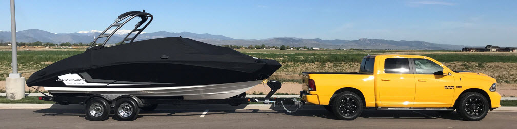

I did 8 or 9" after many tries/an iterative process - I would go at least 8". But - each trailer/combo could be a bit different so it is best to experiment.Appreciating this thread! I just bought my new boat last week, much bigger than the old one. I'm not very experienced with towing and my last boat was the first thing I had ever towed before. On the drive home, it felt kind of weird compared to my old one. I can also see it is sitting pretty heavy on the tongue. I calculated out the guesstimate weight with what I've got on it to be about 5060 lbs. If my math is right I should be looking for a 303 lbs. at the tongue (using 6% for a target). Me and my 80 lbs kid total about 300 together. Which maybe squats my truck about 3/4 in. when we sit on the tail gate together. The trailer squats the truck about 2 inches. I have a Ram 1500 with the raked stock suspension and the trailer levels it. I'm going to give moving the bow roller toward the rear of the trailer a try. I was thinking 5 inches. Another guy I worked with suggested 8 inches. Any opinions on this?
Here is a pic:

Took the boat out today since today we had a small window before 4 days of rain storms. While my wonderful wife waited at the dock I moved it back about 8 inches while in the parking area. It did make a difference and the truck for sure feels better. I can't tell yet if 8 was too much or not, I thought I saw a bit of sway when going past 60. Also with this storm moving in, I was getting 30 mph gusts on the highway going home.I did 8 or 9" after many tries/an iterative process - I would go at least 8". But - each trailer/combo could be a bit different so it is best to experiment.
I’ve been paying a lot of attention to these towing discussions and think you made the right move. And you have a great looking rig. I have a hitch with a scale built in because I’m fanatical about proper tounge weight and tow multiple types of trailers and loads. I’m going to go out on limb here and suggest that those with basic 1/2 ton trucks don’t have the stability over the rear axles that they think they have. And they tend to sway naturally. They also tend to sink more than I would expect with a load. It’s what happens when you try to make a truck ride like a sedan. So maybe a little more weight would help, but in strong side winds with a basic suspension you’re simply going to get moved around a little. I don’t think that means unsafe, just back off the speed. More advanced tow vehicles like my Infinit QX80 have lots of features like anti-sway, hydraulic compensating roll suspension, automatic load leveling and bigger wheels and tires. These tow vehicles are more forgiving, but I still like to balance my load with the proper weight on the ball.It did make a difference and the truck for sure feels better. I can't tell yet if 8 was too much or not, I thought I saw a bit of sway when going past 60. Also with this storm moving in, I was getting 30 mph gusts on the highway going home.
